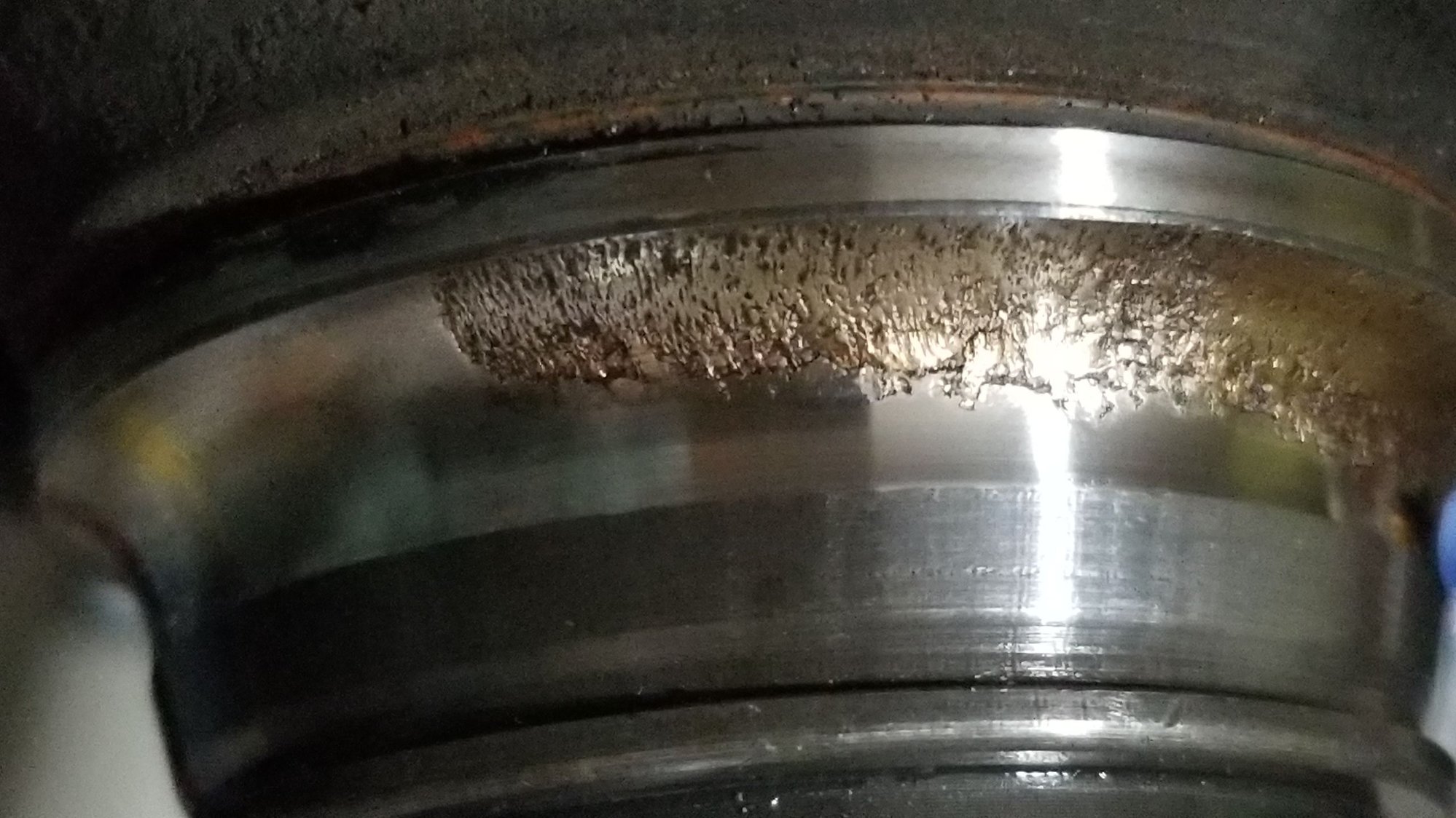

it was so loud in the car you could barely have a conversation. The drivers side bearing was in ok shape but I did that too. One a night. Even though you could not feel any movemennt in either wheel by hand the tracking and total feel of the car were astounding. 2001 996 turbo with 74000 miles. Took 3 hours for the first and 2 hours for the second. Heating to the specification allows the bearing to be slipped right in. I will do the rears next.

Hi... seems so quick to do but never easy.
Curious what bearing Brand did you use ?
Did you remove the complete assembly and use a press.?
How did you heat to 100 ?

This is what it sounded like. I used 2 propane torches to heat the housing.
