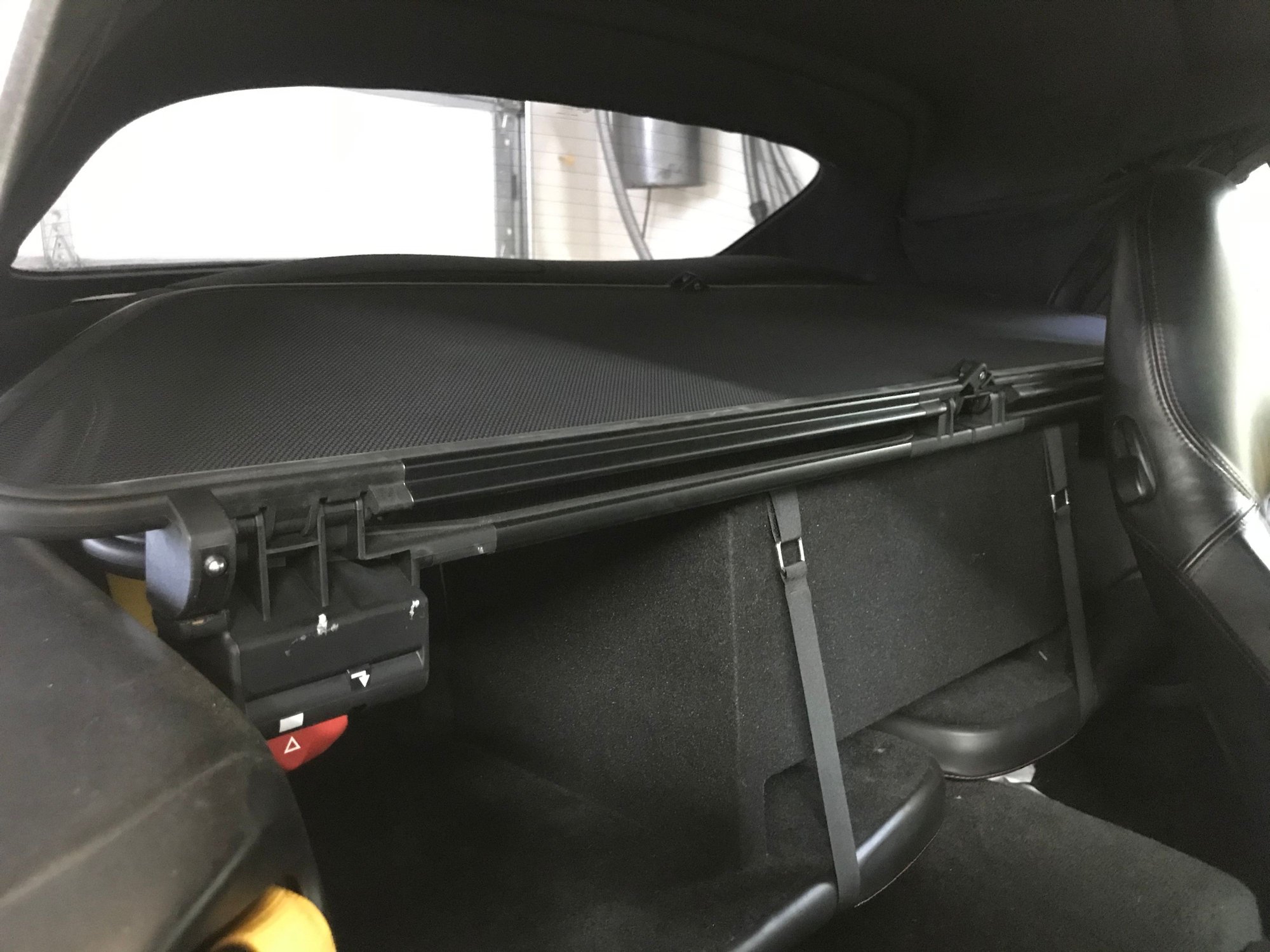

If you don't use the driver's backseat you could try something like this out. I love it.

yup pretty much what I did built a nice box with a 12" woofer, drive it with JL 750.1 works great no issues (did the passenger rear seat area for mine) then just replaced the remaining 6 speakers with aftermarket JL 600.4, bam done

I built a custom box which sits on top of my (folded down) rear seats. Box is held in place by straps and the wind deflector which goes over it. Rock solid and easily reversible. Put a huge 10" Pioneer woofer in it, which fires down on the folded seats. I refuse to pay 400$+ for a stupid subwoofer box.
