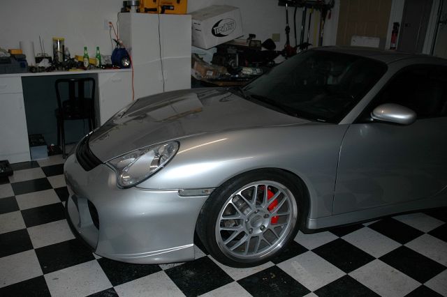

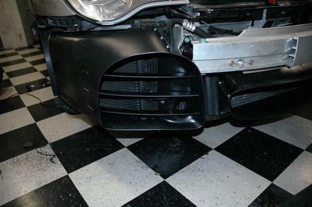

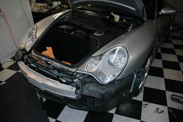

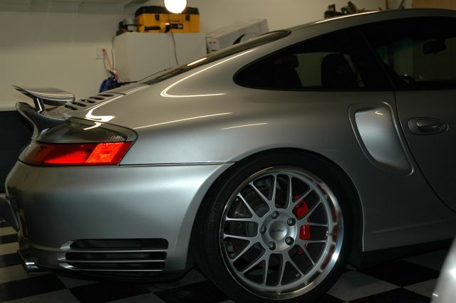

Well, after 6 hours and about 6 beers later, I finally installed my Techart II bumper this past Thursday. Unfortunately the directions from Techart are worse then anything IKEA has ever printed, and I used the factory jack. I need to find a real jack for my car, but since she is lowered, I need something with low min. height.
If anyone wants to do this, please do yourself a favor and find a lift to use. I ended up jacking each side up probably 7-8 times to remove the tire, wheel well cover, bumper cover...then reverse of these. Once I got the OEM skin off, I thought it was going to be easy, but had to dremel some holes for the brake cooling duct work, and had to trim the bottom corners of the front aluminum bumper support to get the Techart radiator ducts in. It is unbelievable how much crap(leaves, gravel, and cig butts) gets in between the side dual radiators. I also had to remount my K40 laser diffuser and radar...what a pain. Anyway, I bought the bumper from a board member, and many thanks to Arling for helping me get all of the parts and hardware needed to make this work. Also got the silver hood emblem....that finished the front off.
Here is 1 before and a couple during install and some after pics.

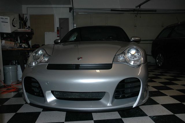

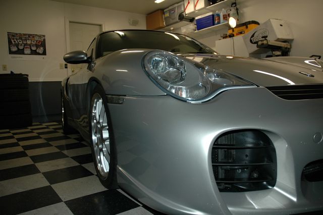

few more pics
a couple more pics. also a side pic...sorry it is in my garage, not the best lighting. will take some more soon. Also need to get the side skirts and rear bumper bottom painted soon.
