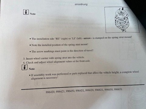

Hoping someone knows the answer to this front shock install question. I've replaced OEM shocks first with HR RSS Coilovers, and now changed back to Bilstein / HR sport springs for more comfort. In both cases I reused the OEM top hat with new bearings, since the top hats are in near new condition.
The picture below shows the OEM instructions stating what appears to be a specific orientation of the 'top hat' piece. I did not see this information on my top hats and installed just as they fell into place. In both cases they work well with no obvious issues. In both cases I can see a portion of the top hat inside the body hole and all part number information is to the front of the car, so that seems consistent.
Just wanting to confirm I don't have to take front shocks back out to check for orientation. Anyone know about this?? Thanks

For future reference - if someone has this issue...I was able to easily drop the struts/top hat and rotate to confirm handing and orientation. The marking were very clear, but somehow I missed confirming this at install. Luckily it was all correct so no changes required. It seems like it would be very difficult to orient incorrectly, the top hats want to fall in the correct orientation and any other way is very awkward.
BTW the Bilstein/HR combo has an excellent feel, seems like what Porsche should have installed stock!
