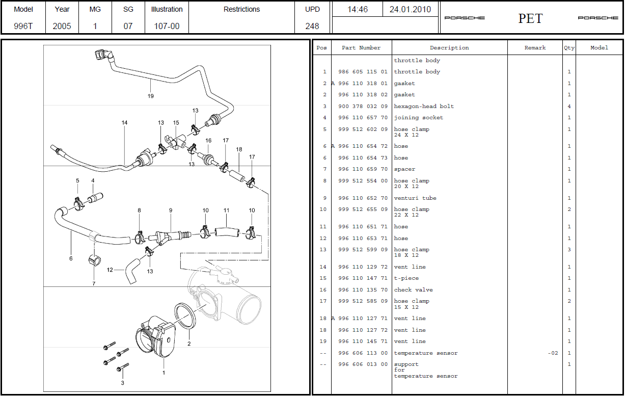

I've tried searching and couldn't find a solid answer. For those of you who have gone MAFless, what did you do with hose #19? Did you just cap off that side of the T (#15)?
I just left it open. There's a check valve to keep it from sucking anything in. 6 years MAFless. Zero issues.

Running mafless as well…..I had a vacuum leak that I chased forever and the #19 was the culprit. Mine had somehow melted down by the turbo end and it didn’t quite cauterize itself when it happened. This gave me a random vacuum leak as it wasn’t sealed off anymore. I replaced the check valve that intersects at part #15 and ran some silicone vacuum line to vent it. At the other end by the turbo I used a cap on the tube.
