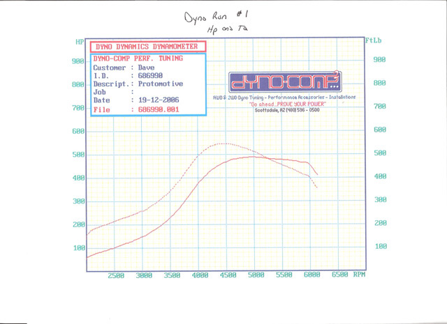

Mark, I think that with technology marching along it is possible to have a small turbo that makes the power of a larger one without the accompanying lag. I know the 24/18G is a 600hp setup that can also take you to the 700hp level, but a well engineered 16/24+ hybrid gives up nothing to the 18G at the 600hp level, in fact exceeds it at almost all points on the powerband. Case in point: Here is AzExotics dyno sheet that was posted and here is my old setup. Now AZ was on a Dyno Dynamics and I was on a Mustang. Most agree that the Mustang will read a little(2-3%) high, but the 18G was running 100octane at 1.35 bar and I was on pump at 1.25 bar so I assume that would account for any dyno discrepancies.
STG2 ZC 16/24......................24/18G
2500.....135HP/283TQ.............100HP/210TQ
3000.....216HP/379TQ.............150hp/260TQ
3500.....317HP/476TQ.............230HP/340TQ
4000.....390HP/514TQ.............380HP/490TQ
4500.....450HP/526TQ.............465HP/550TQ
4700.....507HP/565TQ.............490HP/530TQ
5000.....488HP/513TQ.............490HP/510TQ
5500.....494HP/472TQ.............485HP/460TQ
6000.....500HP/437TQ.............460HP/400TQ
Peak Power 512HP/565TQ........492HP/545TQ
Peak power and tq is better with the hybrid even running lower boost and pump gas.As you can see under 4000 rpm it isnt even close... much more power and torque significantly sooner in the rev range. Over 4000 rpms the power is relatively even until 5500 -6000 where the hybrids carry the power and tq much longer than the 18G's.... I am not sure what "HP range is short via RPMs for small turbos" you are referring to. I will agree that these turbos cannot be caried into the 700 hp range but at 600 hp they are quite impressive. I think you are also aware that my upcoming setup will still be "small" K16 based that will produce SIGNIFICANTLY more power and tq about 1200 rpms sooner than these numbers.... so much for the small turbo theory. Kevin

KPG did your car make 627 AWHP? Or was it 507?

John, peak numbers were 512 AWHP/565AWTQ and I used evos 18.5% loss for an AWD dyno and that got me to 627FWHP/695FWTQ on pump gas... Kevin

Good numbers KPG. I am not sure about compairing dyno numbers on cars with different dyno's, different days, temps., correction factors, etc. etc.

John, it is for comparison only. Nothing more or less, but I cant compare my 128.2 trap with any Proto 600 car since no one has posted yet, but that would make a better comaprison. Kevin.
