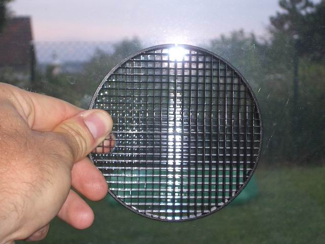

it sounds stupid but which plastic screen is it?
can you post a picture?
thank you!

Looks like this

not sure if the pic loaded last time

Thats what i thought was ,but thanks for the picture.
You think that was the problem?
why factory has it there anyway?
regulate the air?
it comes onn & off easy?
I just put a new maf
do you guys think that will effect the maf to blow if is not there?
any suggestion from others?

that is the "planar" air screen. Used to homogenize the air flow, the "screen" is to eliminare debris.

it regulates the airflow but there is a second wire screen for debris, I mean boy does this make a difference with my set up, its amazing v. surprised nobody else has at least experimented with taking this out, however briefly

I had a look at that thing. It's interesting. The air is cut in squares and then must get kinda stirred up as it leaves the plastic air squarer as the plastic "guides" are not flat, but infact "<" shaped. The air enters on the pointy side. What would the purposes of this be???
