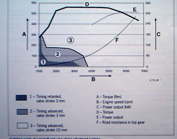

Not true. It does not kick in full till almost 3000 rpm. Once engaged, it should stay lifted through your upshifts. Kicking in at slightly above idle would defeat the purpose of the variocam.

On this graph of the 996TT variocam operating system the engine torque at full throttle is on line D. Area 3 on the curve is full lift full cam advance. at full power above 1100 - 1200 RPM the engine operates in area 3.
The purpose of the variocam on the 996TT is not to improve full throttle low end torque. It makes the engine more efficient at part throttle and idle. Unlike the996TT the 997 TT and some 996 NA models have a continously variable intake cam timing, which may improve low RPM full throttle power. The 996TT cam timing has only 2 positions.
