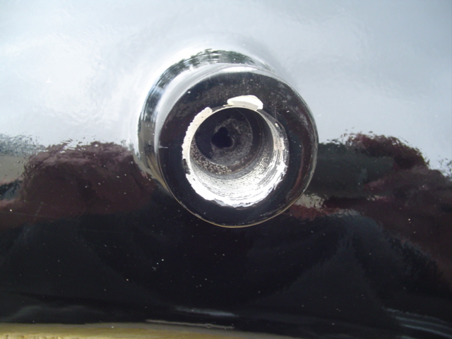

I recently bought a CF TA replica wing from a member here who never installed it. Ive been patiently waiting for the special tool to get here and it arrived today

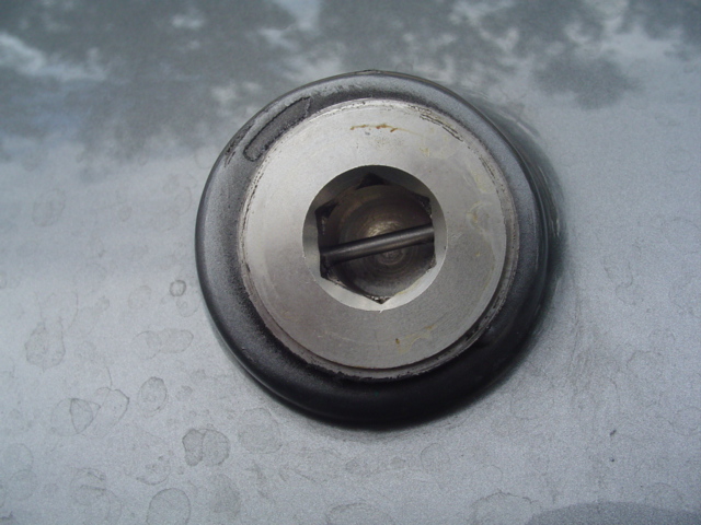

I quicky removed the stock wing and realized that the attachment points are very different on the wings. The stock wing has an inset metal bar which many of you are aware, im sure.
My replacement wing has a female, threaded tube which is bigger in diameter than the stock inset and no bar.
It doesnt even seem remotely compatible.
Am I screwed or is there an adaptor or something??
pics to follow

Stock in gray
TA replica in black

u need to swap that part as well.

I think, you need to unscrew that bolt in the factory spoiler (I have heard it is loc-tite'd in pretty good) and then screw it into the new spoiler. Of course that is one hell of a big allen wrench to get in there.

oops! swap is not the right word.
do what M3CAB said u'll be fine.

Exactly, you swap it from one to the other! Cant wait to see it on your car

might be easier to just buy that part from the dealer... if that bolt is loc tited on it pretty good u dont want to mess up your stock wing..

You can't buy that part from the dealer without buying the entire wing blade. I've been trying. They don't even list that insert as a separate part.
Go to Harbor Freight and get yourself a 14mm hex bit. Makes the job much easier. I just did it myself.

thanks for clarifying that i didnt know that the part was sold with the wing..
