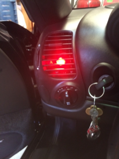

I went with the Raptor LED shift light installed in the duct vent. I wired it to the #9 pin OBD2 tach and a switched and fused 12v battery line. Easily detectable with peripheral vision. I simply close the shutters at night to minimize brightness; very pleased how it turned out.
There is enough slack in the line I can pull it through the vent to change settings after I remove a couple of shutters. No need for full disassembly.

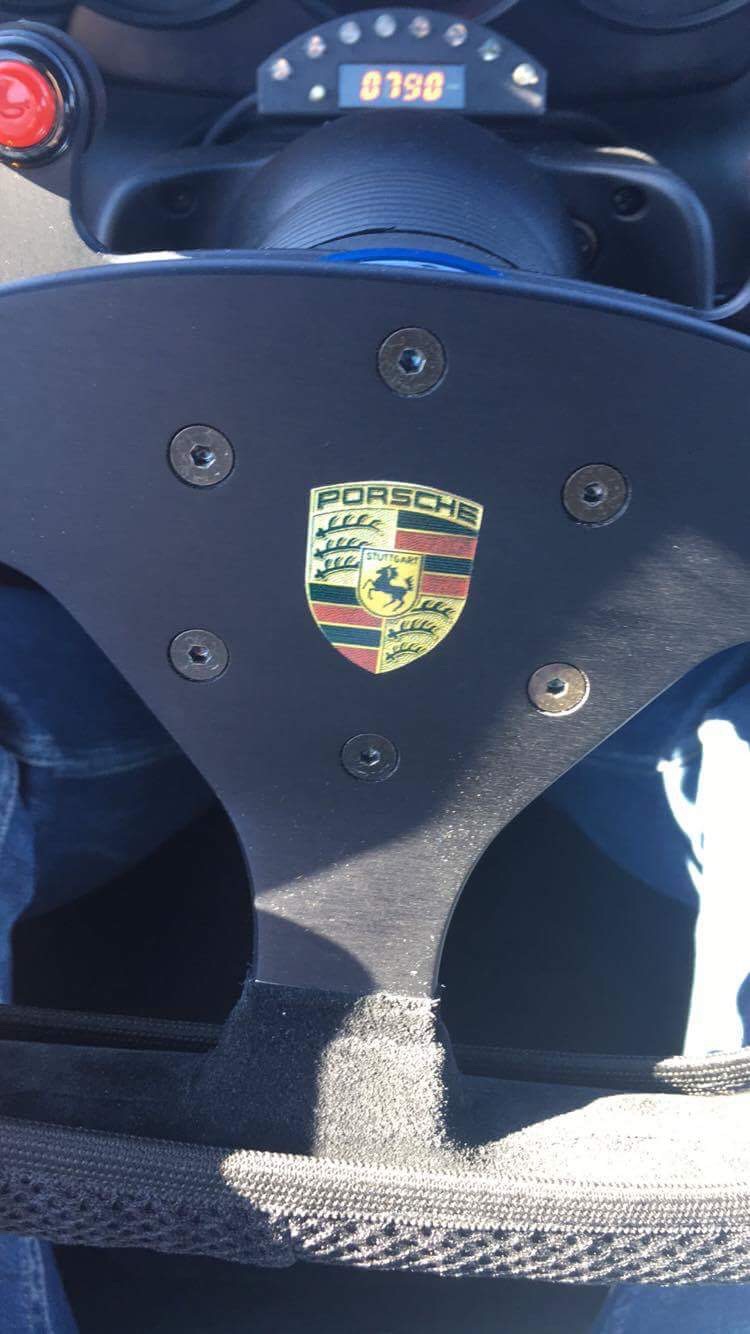

Same problem with small steering wheel. Here is how I resolved it.
