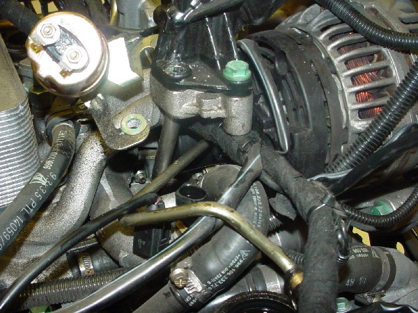

Got the car back from Momentum and when I was driving it I noticed that the oil gage would drop to zero??? is this normal for a GT 700 and how do I check it......... Help Stephen

They bumped the line behind the filter on the pressure switch. It is right behind the oil filter and is gold colored. You can see it if you look closely

so what do I need to do??? is it a swicth?? is it electronic?? a socket... what do i I need to do to fix??

It is a spade connecter. It probably just needs to be pushed back on.

Stephan,
can u point out which part on the pic?

Nope, but I can in this pic. It is in the upper left corner.

great fotos... so what i do push it down or what

seems like everthing is connected... now what??
