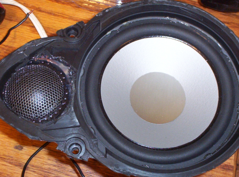

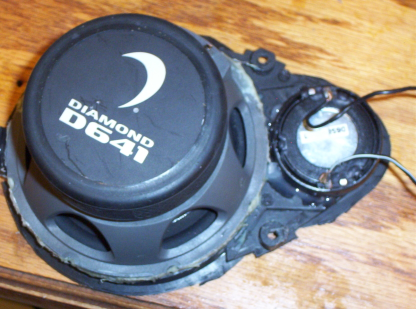

well after much hard work i think i have finally gotten the stereo upgraded in the 996. after trying some mb quartz and bowing them i went to diamond audio and got a 3 way setup from ebay.....
they had a "true" 4.5" speaker, rather than a 4" speaker like everyone else sells. The mounting ring was slightly larger than the previous 4.5" so i had to trim it off slightly in order to make it fit.
the tweeter was also larger than the 1" pre-existing tweeter, (more like 1.75") so after some trimming, i have gotten that to fit....
and of course the mid base speakers were 6.5" not 5.25 like the stock ones (actually measured out to 6.8") so a LOT of trimming on the stock box i got that to fit....

here are some pics, if you are wondering where the amps are they are behind the spare tire! as you can see the diamond audio is the same size as the stock one, just had to trim the mounting rin to get it to properly fit

Do you have any pictures of mounting the 6.5" speakers on the factory door enclosure that you trimmed?

sorry i don't have any pictures of the doors, i need to take them back out to plug up the vents so i will get some in a couple of weeks......
