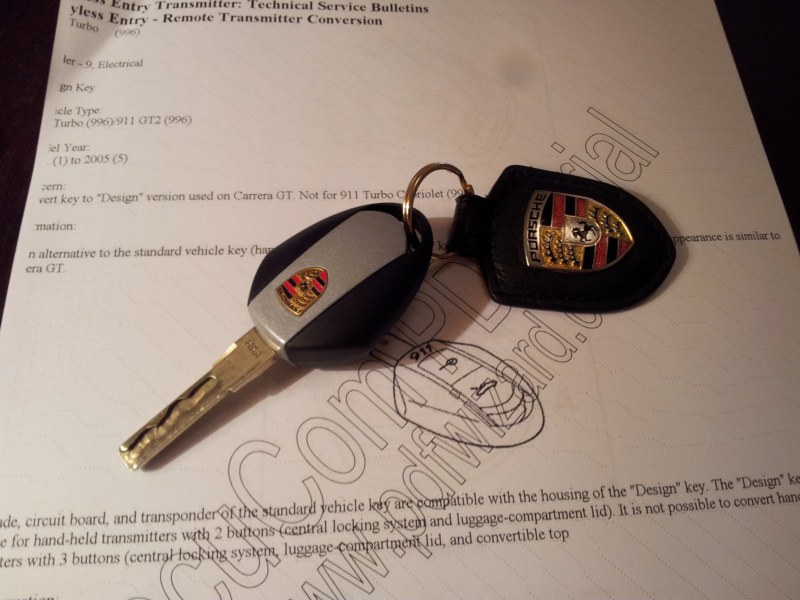

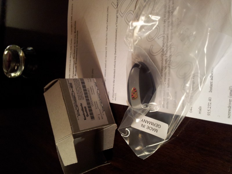

I've this CGT key on mine, it looks really better than the old one!
Be careful when doing the mod with the inside parts of the key.
Two pics:

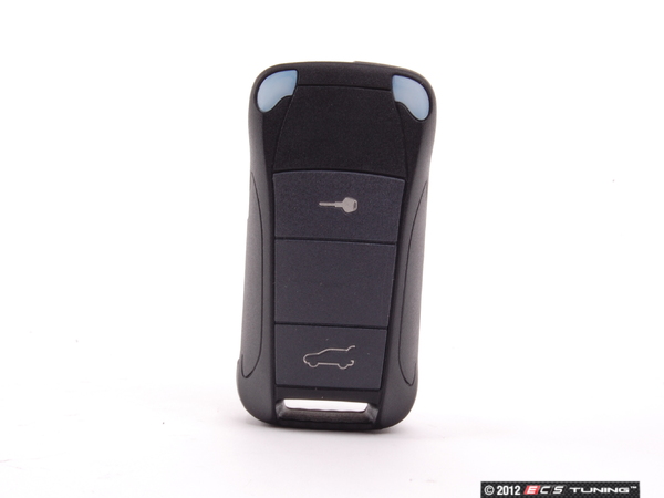

Any options for the Cayenne? My 996 keys look great. The Cayenne... not so much...
Dennis we don't currently have any other different options but can get you a new key housing for your Cayenne like the one show below. For more information Click Here.

Is it pretty simple to switch the blade and electronics like the 996 key? Also - my 2004 Cayenne uses the "one button" for lock and unlock key fob. I don't think I can use the one pictured.

Dennis I would think it should still work, as the internals would be all switched out. The only problem is that the "lock" button wouldn't do anything, and the "unlock" would perform both lock and unlock functions. The electronics are fairly easy to switch out but, but the blade has a tiny roll pin that must be tapped out. It's really not that hard as long as you don't loose it. For some reason I thought you had an 06', sorry about that, your better bet would be to go with the one shown below as I have not personally tested the the 06' transmitter model on a 04' but might be something we should look into. For more information Click Here.

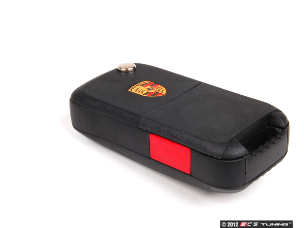

Howdy, any chance this switchblade-style cayenne key will work with a 996 key (newer, 2003 with two button)? The CGT style key is still so old school, so if I am upgrading, I would like to upgrade to a switchblade.

They both use the same frequency, so it's possible if you want to get it cut and coded to find out. Of course, there's also a possibility that it may not.
