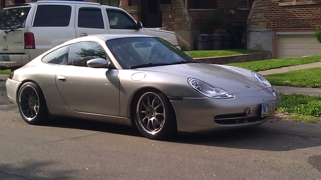

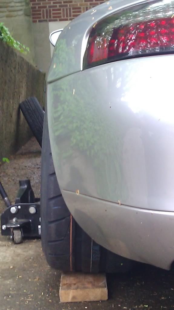

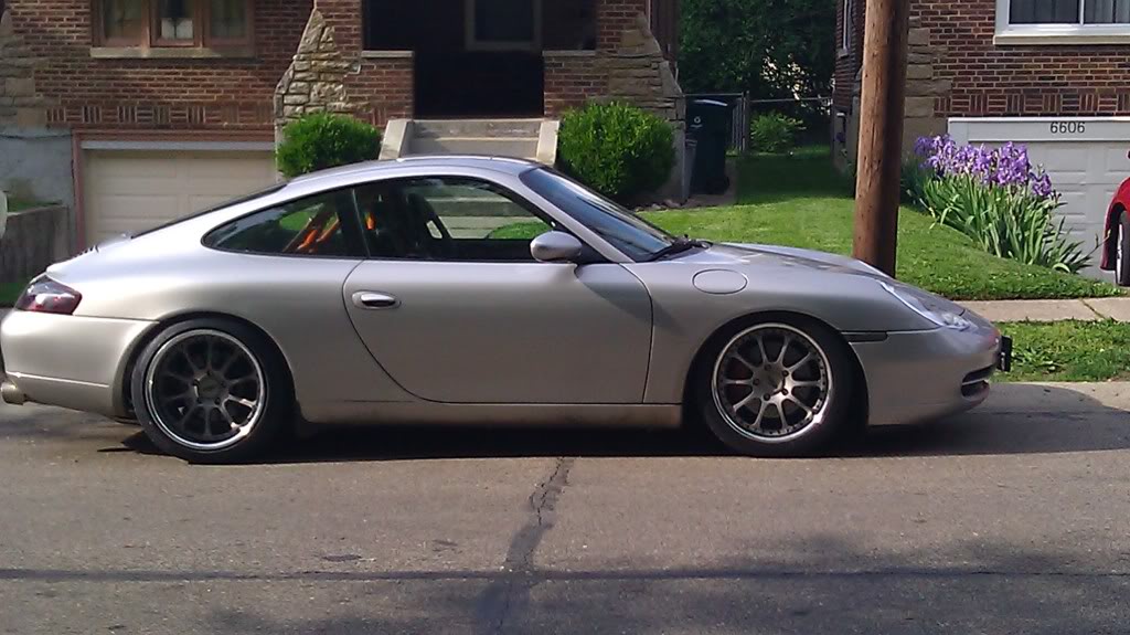

mk1 kinesis ET52 or 53 variant v3s with rolled fenders

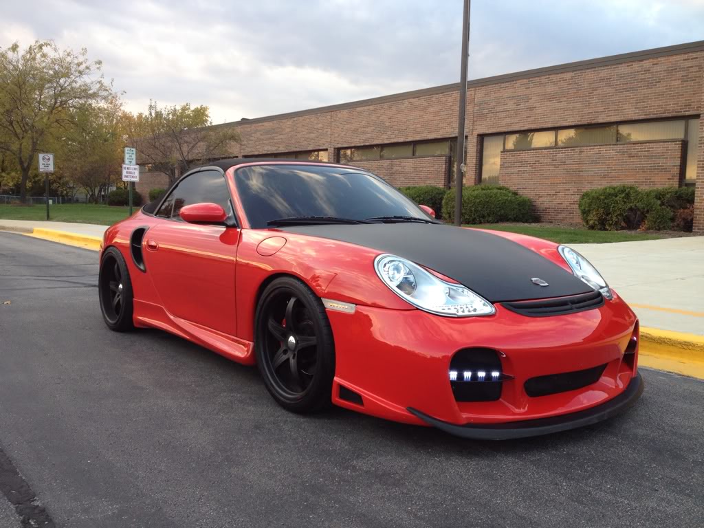

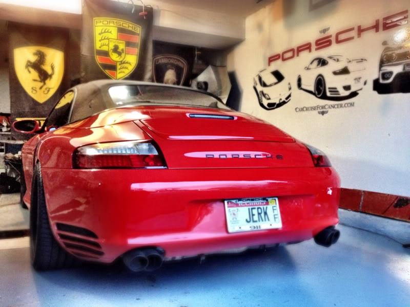

I have turbos 11" on mine with cut and rolled fenders and lowered and I still rub on dips
But sure looks good

Old Jul 15, 2012 | 07:12 PM
MadeInPorshe's Avatar
Joined: Sep 2008
Posts: 205
From: Vancouver
MadeInPorshe is infamous around these partsMadeInPorshe is infamous around these parts
But sure looks good
Wow that looks really good, did you add those side vents?
Old Aug 10, 2012 | 08:58 AM
matthewbounds's Avatar
Joined: Nov 2011
Posts: 372
matthewbounds is a jewel in the roughmatthewbounds is a jewel in the roughmatthewbounds is a jewel in the rough
What are the offsets on your Turbo 11's?
Old Aug 10, 2012 | 01:09 PM
Nine_Eleven's Avatar
Joined: Feb 2010
Posts: 599
From: Bay Area CA
Rep Power: 40
Nine_Eleven is infamous around these parts
I think he just has the Turbo vents. That's a 996.1 Cab.
