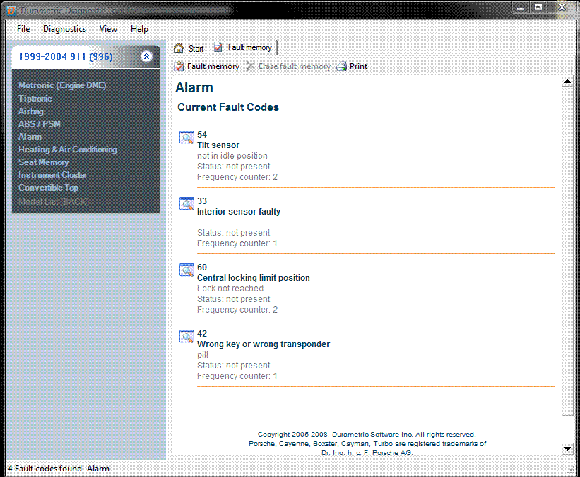

So my alarm has been randomly going off when locked and sitting idle. Happens mostly when the tempurature changes throughout the day.
Driving me bananas and I am hugely unpopular with the neighbors.

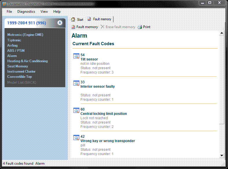

I bought a Durametric scanner to try and track down the offending sensor, and initally thought it was the interior sensor. I replaced it, and it is still falsing.
Now when I looked at the durametric after the latest false alarm I saw that error code 54 for the tilt sensor had incremented by one count, and noted with "not in idle position"
Does my '02 US car have a tilt sensor and where is it located?

update-
So I discovered that code "54" is for the radio alarm wire. Durametric is updating their software to show the proper discription for this code.
I pulled out my Kenwood NAV and saw that I had re-plugged in the blue/brown alarm wire to the factory radio mount bracket. This apparently was not sending the proper feedback signal to the alarm with the Kenwood installed, hence the occasional false alarm.
I disconnected the radio alarm wire and it seems to have fixed the issue.
