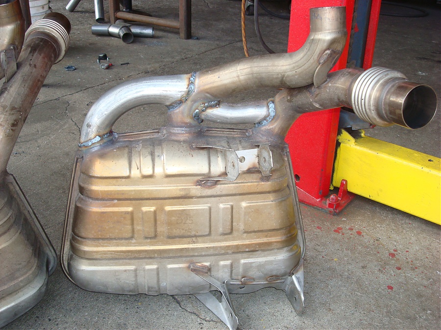

After many months of searching, waiting to get a pair of 997 exhaust so I can do some mod. to fit on my 996.
Finally, I received a pair for nothing from EBAY to work on. The result is astounding. The exhaust sound is impressive and what I have expected. It sounds much better than the Fabspeed exhaust that I had.

Thanks guys! The tips can be remove for switching. I didn't have 997S tips yet so I use a set from non "S" ones just to do the shoot. I took the video right after the work completed.
On cruising speeds there is no droning at all. The advantage of using 997 cans you can do twin by-pass pipes to get more aggressive sound.
Any pix of the hack? I'm not sure about the twin by-pass.

cool, so 997 can fit the 996? What bracket did you use?... I guess you can get the 997 sport exhaust as well. From what I heard, the x51 exhaust has dual outlet pipes...

Just did this on a C4S...
Did the H pipe between the intake pipe and exhaust pipe and it sounds awesome. Used 997 s mufflers and it sounds a little like a tubi and just screams in the upper end. If you lug it, it's no louder than stock. However, the shop had to cut and extend certain pipes to fit. Super happy with the results. Louder than PSE for sure!! Anybody who is contemplating Bypass pipes with no mufflers should go this route, it's way more liveable.
You can use your 996 bracket for the 997 can. Yes, the x51 has dual outlet pipes. I use non "x51" exhaust.

Here are pics. of the 997 cans. Also I have a set of 996 cans modified, anyone want them let me know. $175 and they are yours. Thanks!
