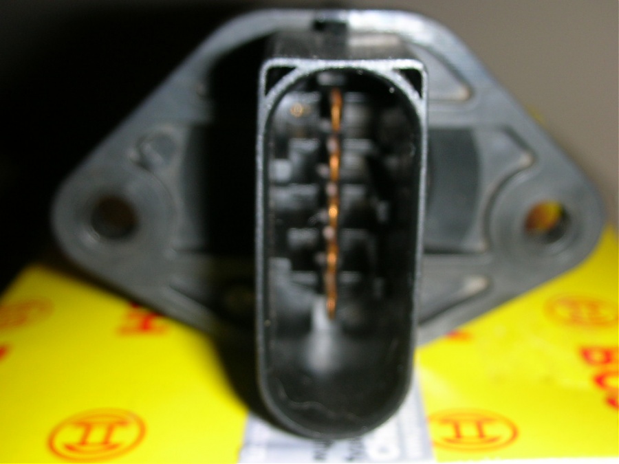

Originally Posted by p0rsch3
I think the only issues recorded were with 99-01 cars with the early MAF sensor. Cleaning it with an electrical spray-clean or updating it to the newer MAF solves the issue.
What else can you tell me about the "updated, newer MAF" for 99-01 996?
When purchasing a new MAF, how can you tell if it is an "updated" version?
I have a 99 996 with a K&N and I tripped my MAF. I usually just quickly disconnect the battery, clean the MAF, and reconnect the battery. This fix usually only lasts a week.
I enjoy the performance and sound upgrade of the K&N, but I would also like to properly correct the CEL due to the MAF.
Wow sorry to hear that- In regards to the newer MAF, I'm repeating what I've read in other related posts here on the six. Check with your local Porsche dealer to see if there is an updated part number. Did you re-oil the filter recently?
I didn't apply any additional oil on the K&N filter when I installed it. In fact, the filter seemed to be only very lightly oiled right out of the box.
I bought a MAF sensor off a fellow 6-speeder in hopes of it working in my car. Neither of us knew if it would fit for sure, but when I received it, it was slightly different and cannot be plugged in due to a slight design change. The MAF I bought has one side of the plug in area squared off on one side.(see pic) I have it for sale in the "Parts for Sale" folder.
