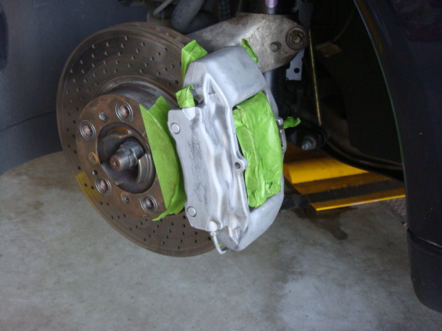

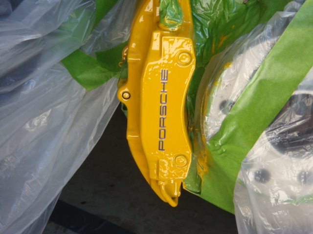

Euclid,
I have a thread over on Rennlist that shows my experience with Duplicolor ceramic high-temp. paint. I went with yellow calipers and sapphire blue text on my midnight blue C4 cab. What a difference from the stock "titanium" caliper color! I would do it again without question. I have to tell you that a member on Rennlist told me that he used Duplicolor blue on his calipers and then tracked the car. Apparently, the brakes reached a temp greater than 500 degrees F and it turned the paint black. I have had no problem with mine during "normal" street driving. (YMMV) Here are a few of my pictures...

Wow that looks great!
Did you strip your calipers all the way down to the metal or just rough them up?

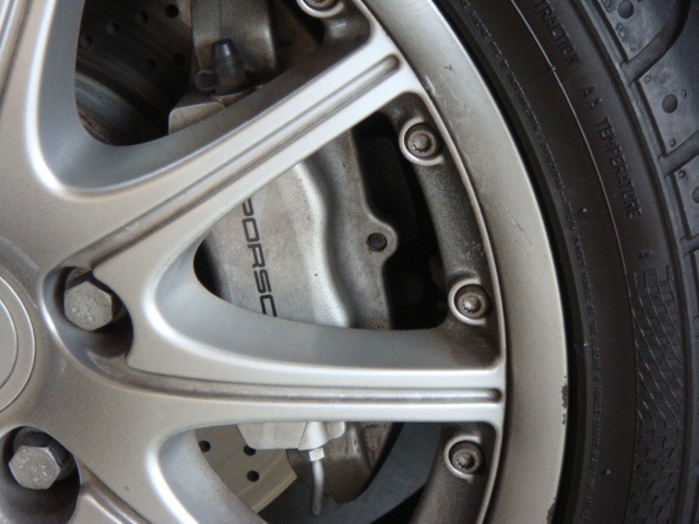

I used exactly what you bought. I couldn't find my pictures of the job on the rotors, but this was taken about 6 months later when I painted the hats.

Looks great!
I used the brake cleaner included in the kit and a wire brush I picked up at Sears. Mostly, I was trying to rough up the old paint for better adhesion but alot of it came off. Good luck!
