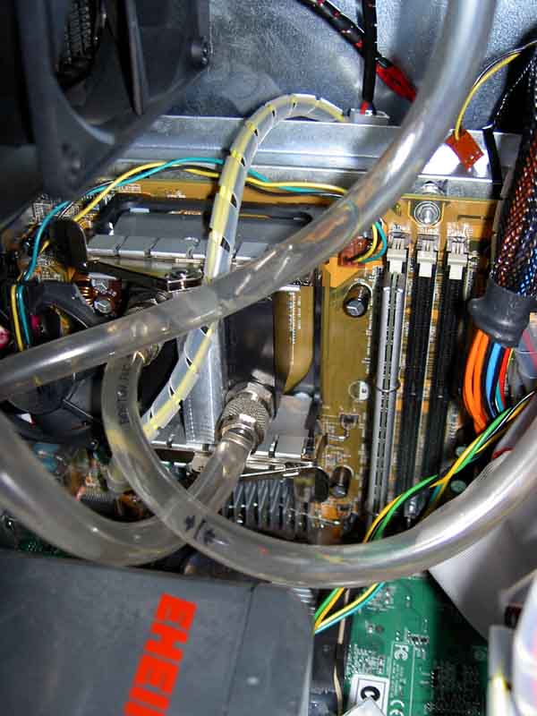

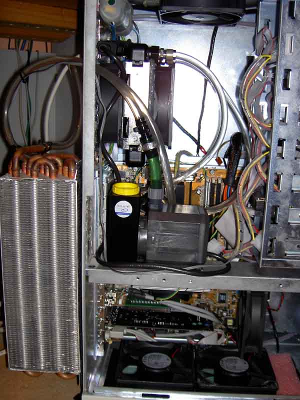

Scott,
My PC is an Intel P4 based system (2.6 GHz CPU) running at 3.4GHz Overclocked + Water cooled.
Running 2 radiators (1 Internal + 1 External) and a few fans + a 600 litre/hr fishtank pump. The fans are 24v units running at 12v - This allows the system to run very quietly!
Most overclocking requires a lot of extra cooling and the easiest way of accomplishing this is by adding a larger heatsink on your cpu + high speed fans.
High speed fans = High noise which I dislike.
Watercooling is slowly becoming more mainstream and you can actually purchase complete kits.
The whole idea of overclocking is basically to push the system to its limits with the available hardware...A bit like modding your Porsche with superchargers etc.... Just a whole lot cheaper!
Here is a messy pic of insides.....
