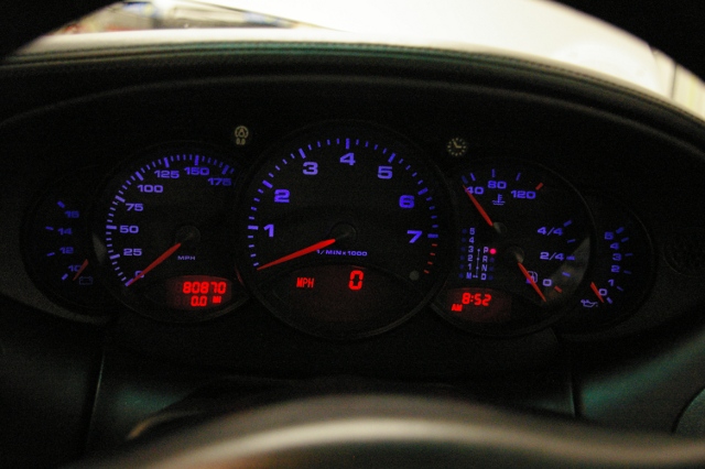

I've been looking through this thread and the www.porscheleds.com page, but still have a few questions:
  • Are the same "Tiny LEDs" used everywhere (instruments, aircon unit, switches,...) ?
  • Are red LEDs required for red digits in the instrument panel and the aircon unit?
    • If so, how many are required and where can you get them (porscheleds only seem to have super-white and blue)?
Does anybody know?
Thanks,
Bjarne
Old Feb 14, 2010 | 05:35 AM
  #38
tb996's Avatar
Posts: 35
From: uk
tb996 is infamous around these parts
Does anybody know?
Thanks,
Bjarne
1. The instrument LEDs are different to the rest [no soldering required], from memory there are 2 sizes with half turn twist clips.
Haven't changed the switch LEDs yet but fom the desciption and price they look the same as the Aircon ones.
2. Red LEDs will be needed for the instrument dials.
3. For the Instrument panel you will need 3 twist LEDs to replace the bulbs behind the digital LCD display,
and 2 large & 2 small twist LEDs to replace the bulbs behind the dials
Will ask around to find out where you can get red ones.
