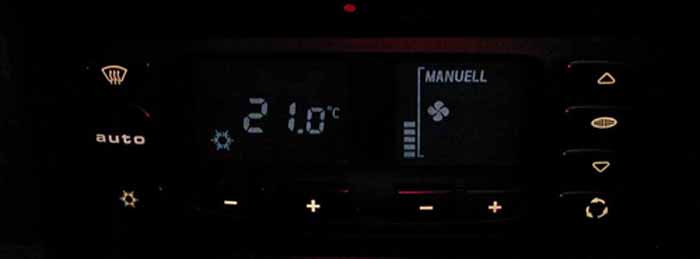

Old May 13, 2009 | 02:57 AM
tb996's Avatar
Posts: 35
From: uk
tb996 is infamous around these parts
Aircon leds are a real pain in the butt to change. Best to swap them one at a time and check the new one is working before replacing the next. They are only 3mm square and really need careful soldering as they will start melt after a couple of seconds. The orange filter needs to be replaced with a good plastic white one or the colour is not so good. Hope these pics upload.
TB

That looks so much better. Anyone else have pics? Is there any place to send the aircon unit out to have this done?
