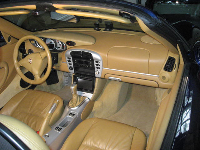

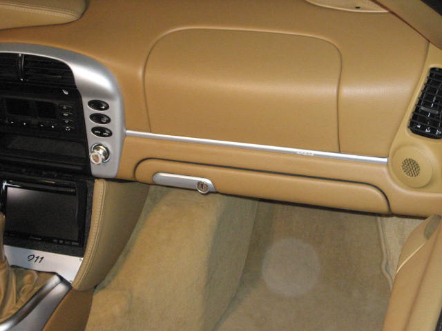

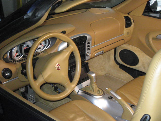

I finally got around to installing the Porsche OEM dash strip I bought 2 years ago. I think it ties the whole dash area together and breaks up the Savannah beige really nicely. The best interior mod for the money so far.
I few tips to add to others advise. I used the soldering iron method with a twist. I did not pry the top portion of the trim piece off prior to heating the screws up. It was much easier to use the new strip as a template to mark the location of the screws. I then used a drill bit a to drill through the existing trim piece to expose the screw points. I then placed the hot soldering iron on the end of the screw and applied constant pressure until I felt the screws push out of the trim piece. I was then able to easily pry the strip out of the dash from the exposed end. Once I had the technique down the whole job took 20 minutes. The second time doing this would be a breeze. I then just snapped the strip into place using the tabs on the trim piece and it holds securely. As others have posted make sure to tape off the dash to avoid damage if you slip and remove the side vents and center horse shoe. Below are som pics of the finished product.

A few additional tips.
1. Use multi layers of Duct tape above and below the strips.
2. Use a size 3/16 drill bit. I used a hex ended driver bit in a small Skill iXO driver to make access easier and allow for low speed drilling.
3. Mark the first hole and drill. If off slightly re-adjust using trim piece and mark rest of holes. If you miss a screw by a large margin drill a second hole to allow better access.
4. Drill thru plastic until you hit the screw point. You will be able to look into hole and see the silver end which is flat. The more centered the the hole the better.
5. Use a pointed round soldering iron tip that is smaller than the 3/16 drilled hole. Put the tip of the hot soldering iron directly on the end of the screw and apply constant pressure while heating. I used a fair amount of pressure. When you feel the screw release and depress about 1/8 of an inch stop pushing and remove iron. It took about 10-20 seconds per screw to complete.
6. do all the screws along the full length of the trim piece prior to attempting to pry the piece from the dash, you may need to repeat heating and pressure step if it does not pull away. Don't be afraid to pull firmly. Do not press screw to deeply pushing the screw out the back of the dash.
7. Use a needle nose vice grip or pliers to grab the end of the strip once you free the first screw.. Place screw driver behind trim on exposed side of trim to create a gap for the needle nose pliers. You may be able to just pry off with screw driver as well.
8. Wipe down dash remove Duct tape and press in new trim pieces. Replace side vents and center horse shoe. You can use silicone adhesive prior to pushing in place if desired. Mine seems to be very secure so I will wait and see.
Good luck
