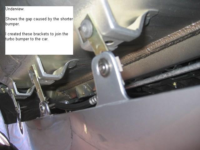

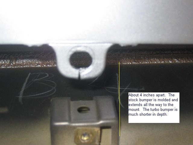

1) the bottom (base) of turbo bumper does not extend as far as the stock bumper. This means that none of the bottom mounts on the turbo bumper will align with the car's mounts. I needed to create metal extensions/brackets to attach the bottom of the bumper. Others have chosen to use tie wraps, but the fabricated brackets are more secure.

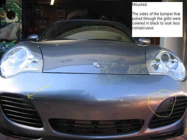

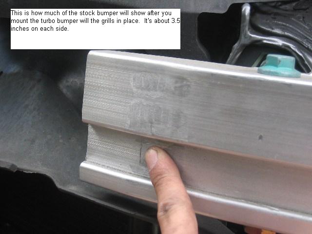

3) the side grill openings on the turbo bumper are obviously wider than stock, so the steel bumper protrudes through the openings. Some have chosen to cut the steel bumper, others to paint it black. For now, I wrapped it in black tape so it blends in with the grills.

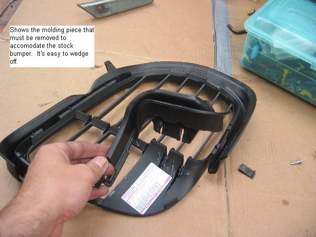

4) you can reuse your stock vents (the ones behind the grills). The turbo vents would be a better fit; for now, I kept the stock vents.

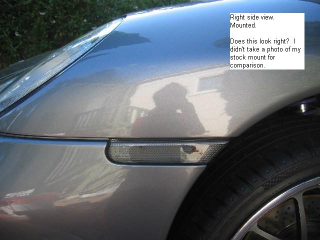

The turbo bumper is a perfect fit, width-wise. Maybe I'm hyper-picky, but I feel that it could be tighter under the headlights. If I could lift the bumper vertically by 2mm, I think it'd be perfect. See if you guys can tell what I mean from the pictures. All of the screws are aligned right.
The grills could also be a bit tighter in the bumper. Be careful if you buy a used turbo bumper, as the grill mounts are very easily broken if not removed properly.

Picture 1
Pic 1 - Underneath the bumper

Pic 2
With brackets installed.

pic 3
Side grills (pic 1 of 2)

pic 4
side grills (pic 2 of 2)

pic 5
steel bumper that shows through the grill.

why did you start chopping up the left and right grills? is that because you didn't cut the metal bumper underneath?
