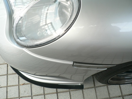

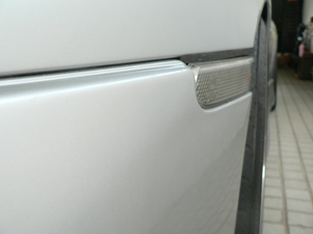

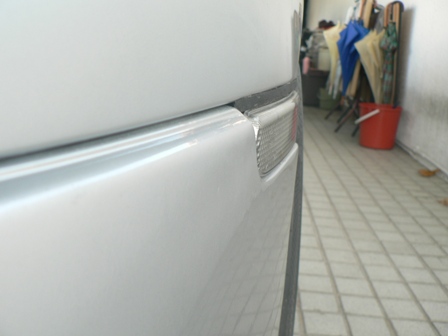

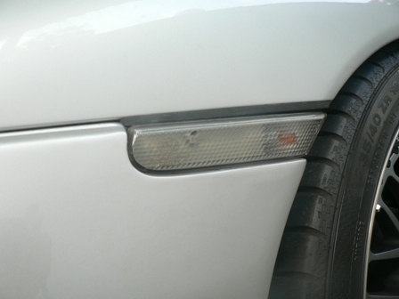

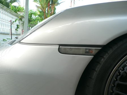

Hi guys!
I've attached some close-ups of the problem areas. Would really appreciate any good suggestions on minimising the gaps, and also aligning the side markers with the fenders. As you can see, the side marker on the passenger side (mine is a RHD) is not exactly flushed with the contour of the bumper. I have found another installer, and he is suggesting re-working on the bumper and adding some fiberglass to at the bottom part of the space reserved for the side markers to push them up, and close the gaps. Can that work?

My installer meant the waves on the fibreglass. Well, he has apparently smoothen them out, but he warned that they may re-appear. I have no issues at the moment. The alignment and gap of the side markers are my main concerns now.
Lastly, to sidetrack a bit - do you guys recommend adding silicon to close up the gap between the side skirt and the main body?

I think they are still short of doing a good job. I don't have the TA bumpers but to relate my experience, fiberglass, even in the hands of someone that knows what they're doing, doesn't get installed overnight and you'd be hard pressed to even have it done properly in a week. When my front and rear bumper covers and side rockers were installed it took all of 10 weeks... granted I wasn't the only car in the shop, but to marry all of the edges flush takes some time, especially if they have to build up some fiberglass in some areas... I told my installers to take their time and they did, and in the end I'm happy that they did... The caution when I undertook my facelift was that the parts really are secondary to the skill of the installer and from your pictures and your caveat (installer not experienced with porsches) I guess it would be true...

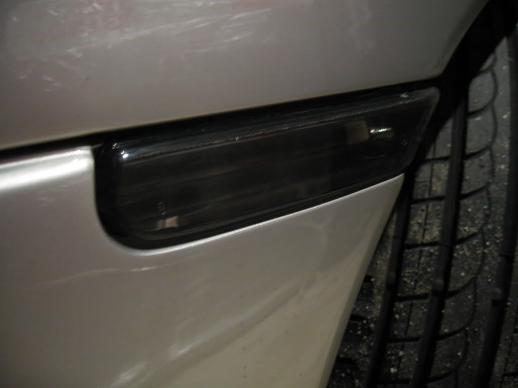

and for the sideskirt and mainbody, i added silicon to mine
