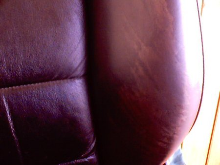

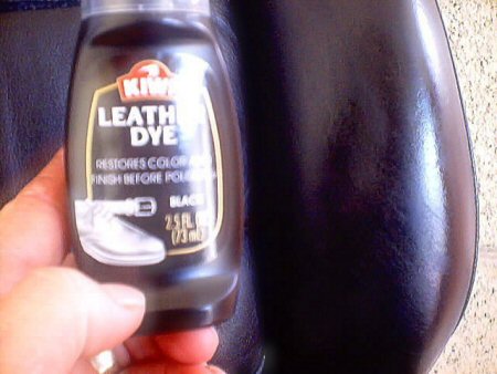

I used the KIWI dye in black on the seat bolsters and it does work well. however it wears off pretty soon. I think leatherque or something like that is supposed to be better. Pics are before and after
