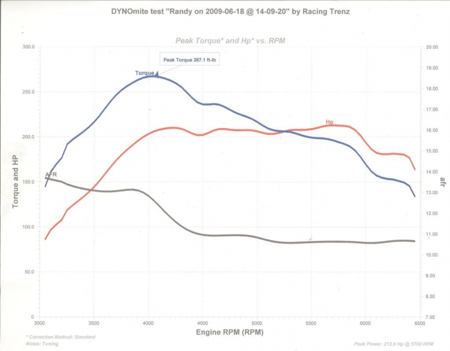

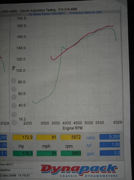

Old Sep 28, 2009 | 10:10 AM
Adandos's Avatar
Joined: Sep 2009
Posts: 9
From: Saudi Arabia
Adandos is infamous around these parts
you didn't read the whole thing
somewhere in there it says "so the only time the ecu goes into open loop is off throttle"
the answer is yes
the code in the ECU switches to open loop at 105% throttle (never switches over).
Attached
WRX dyno clearly holding 13:1 up to 4000 ... in boost
C230 Kompressor clearly holding 14:1 or leaner up to 4500 ... in boost ... remember this is a kompressor ... it can boost off idle
Old Sep 28, 2009 | 10:28 AM
1999Porsche911's Avatar
Joined: Aug 2004
Posts: 2,134
From: Chicagoland
Rep Power: 123
1999Porsche911 has a brilliant future1999Porsche911 has a brilliant future1999Porsche911 has a brilliant future1999Porsche911 has a brilliant future1999Porsche911 has a brilliant future1999Porsche911 has a brilliant future1999Porsche911 has a brilliant future1999Porsche911 has a brilliant future1999Porsche911 has a brilliant future1999Porsche911 has a brilliant future1999Porsche911 has a brilliant future
the answer is yes
Attached
Well, their answer is wrong. Also your chart proves that your a/f fuel ratio gets richer as you go into WOT. First chart continues to get richer until it reaches about 11.5:1.
