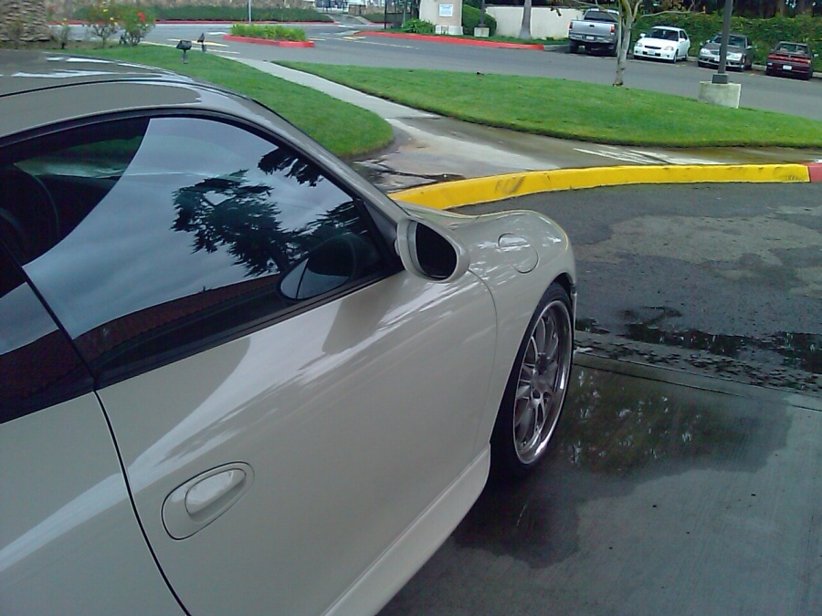

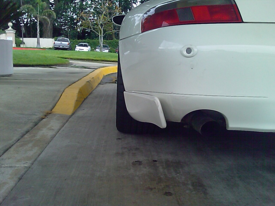

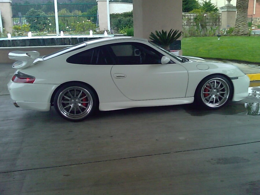

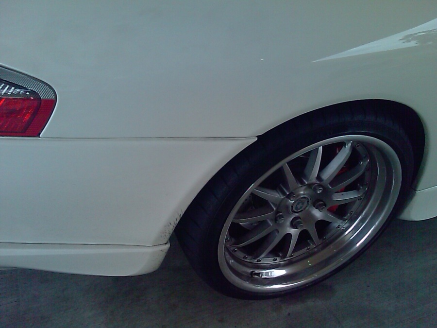

pics of 11.5 width tires 315/25 18
Thanks again...and btw your car is beautiful.
