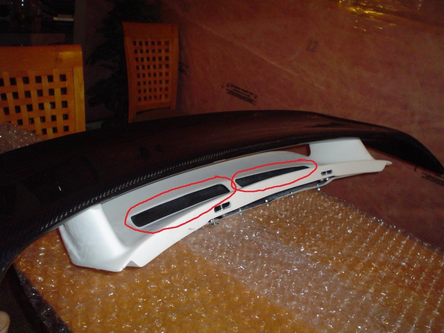

Are there any inserts available for the inlets? don't want to put wire as I do not like the look. CF of even black plastic would be nice... What did you other guys do. This is the misha gt2m wing... See pic below to see what I mean...

Good news is the 997 gt3 oem grilles are only like $15 each at the dealer.. bad news is they are about .5" too short! I know, I bought and tried with the same wing!
I gave up after that and have the two empty holes...

Yeah, empty holes. I don't think you'd put anything there that would restrict air flow. BTW CF looks nice!

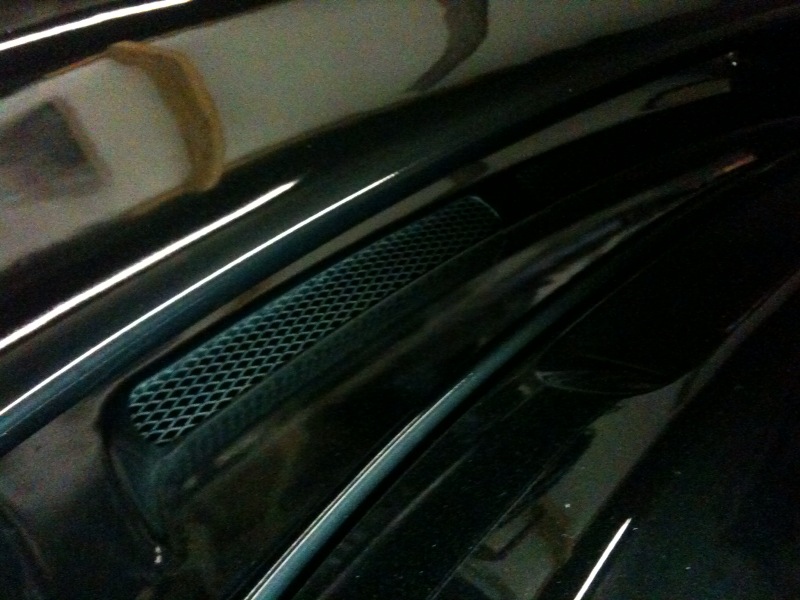

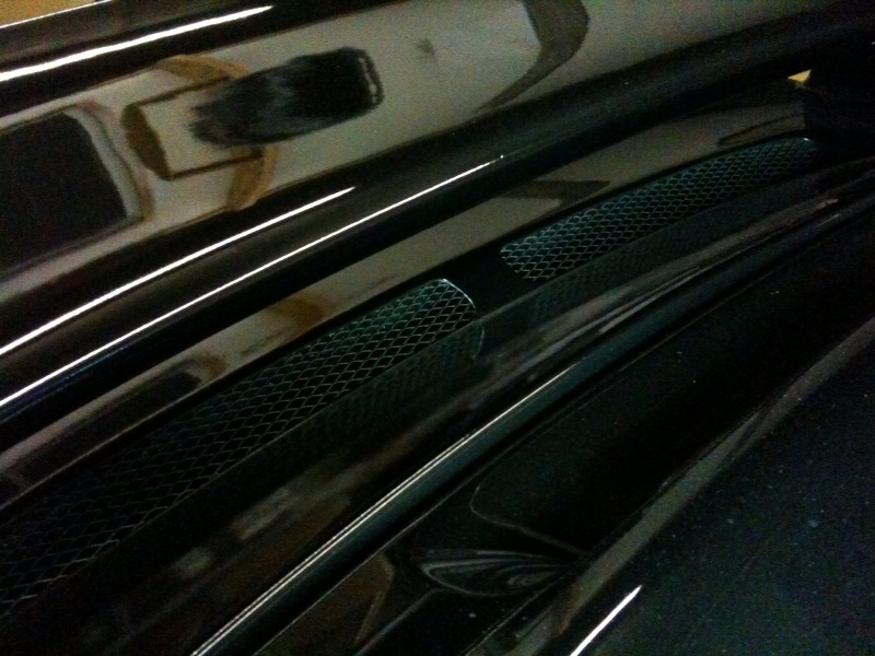

I used black hex mesh the same as is protecting my rads... Works perfectly, looks stock and understated etc etc etc...

Dervish, is that a CF insert cover for your inlets, hard to see in black??? I see the mesh...

I used a mesh looks really good and does'nt restrict the air flow

Yeah it's glued on

Looks good
What type of glue did you use and who has that mesh?

It's a CF 'ram air spoiler', it forces more air into the intake and also provides more downforce. Not sure how much difference it actually makes on a Carrera. On a GT3 it produces an extra 15bhp over 100mph???? It screws on to deck lid with 2 screws then I used black silicon to seal (you can't see it).
For the mesh I used Araldite epoxy resin, very strong and works perfectly. Just take your time to avoid mess...
