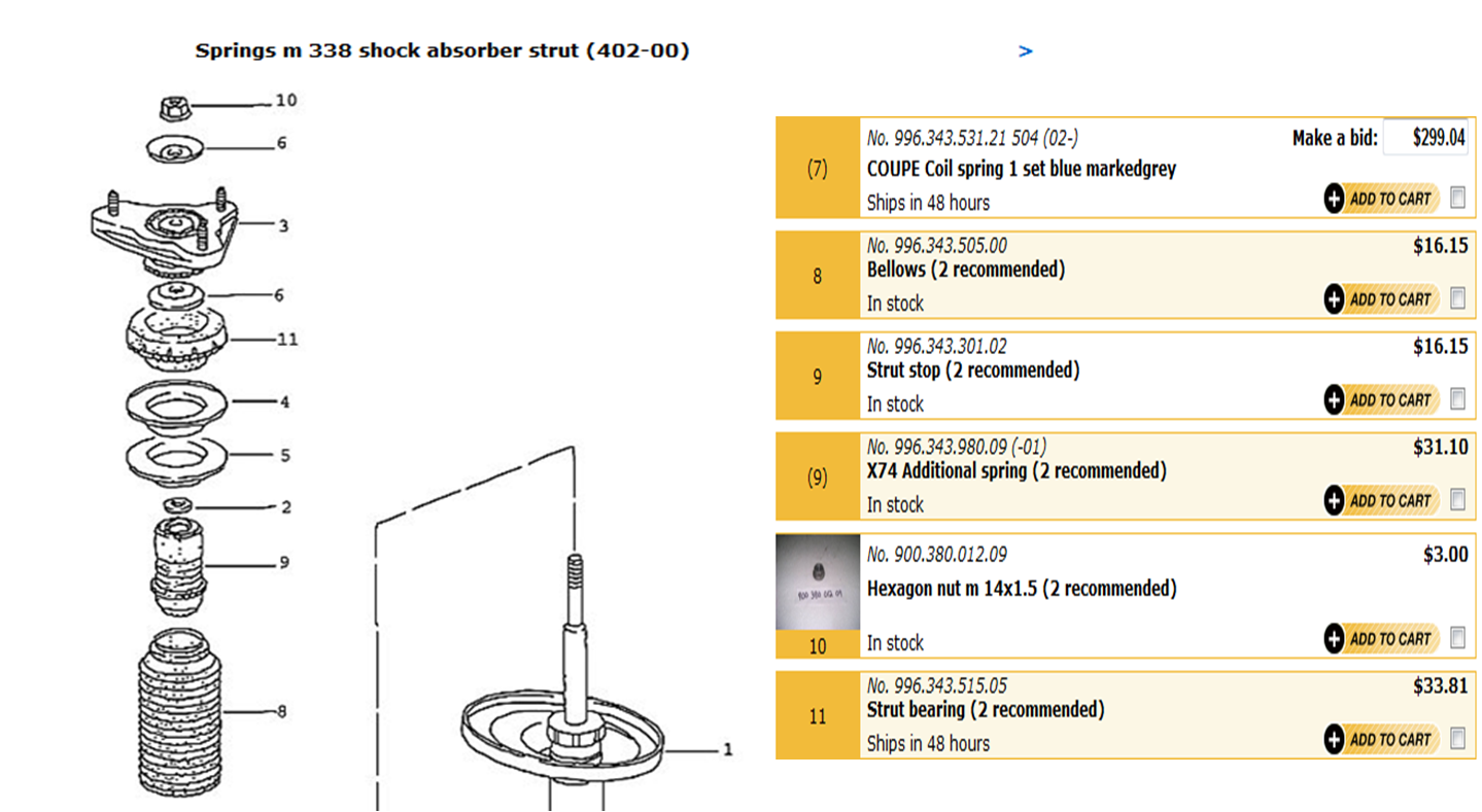

Here's a detailed components picture. I think its the strut bearing... Help

Change the Strut Mounts
