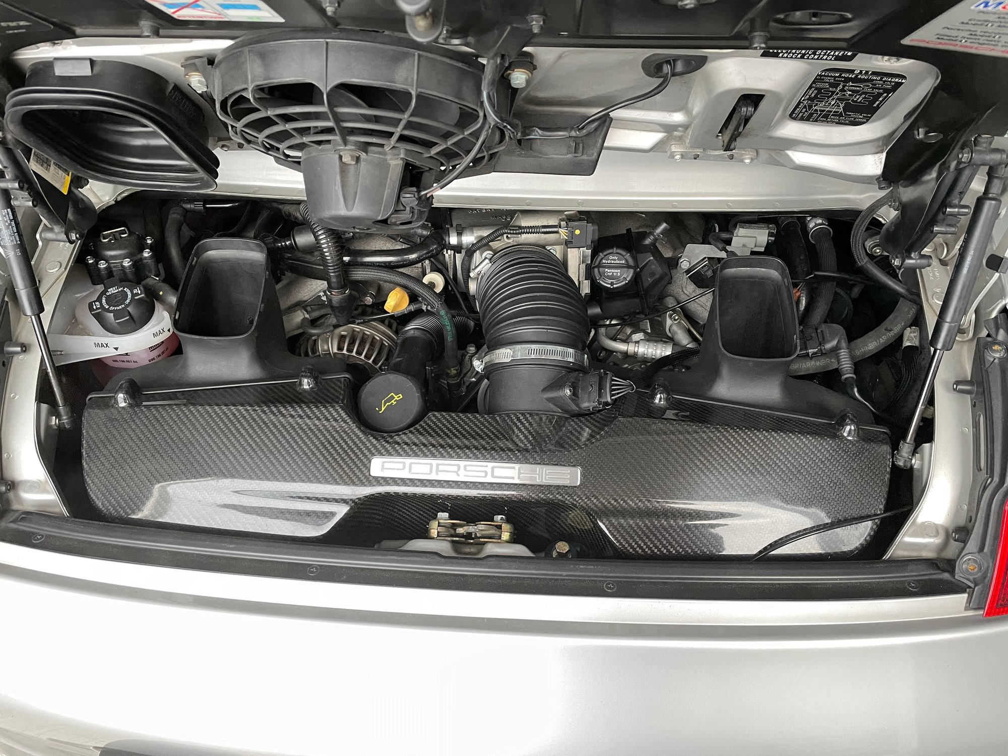

CF air box from 997 X51 into my 2002 996 C4S, engine is from a 2004 X51 40th.
still working at adding the 2nd air intake in the deck lid.

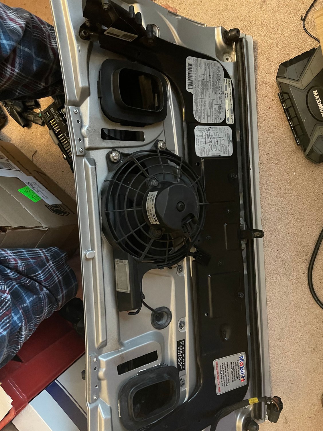

Need a few things like MAF extender etc.
Throttle Body: #997.605.116.00
Distributor Pipe: 997.110.416.40
Rubber Sleeve: 997.110.685.40 X2
Hose Clamp: 997.512.694.00 X4
Electric Line (tank vent line extension): 997.607.130.00
Tank Vent Line Support: 997.110.429.40
Support for throttle body: 997.110.423.40
Support: 997.110.433.40
Tank ventline including Valve: 997.110.129.40
Tank Ventline: 997.110.127.40
Looks like above you are missing: X-51 side bellows is # sc997-110-252-00. The bellows left side (looking at the engine) is # sc997-110-250-00 circled in red.
Should fit into the yellow attached sleeves for the deck. Or did you pull your stock left one off and flip it over and stick it to the deck?

correct, still working at adding the 2nd air intake in the deck lid.

Tricky indeed. Here’s my 996 C4S lid with the extra hole, it’s not a perfect fit but I think it will work.

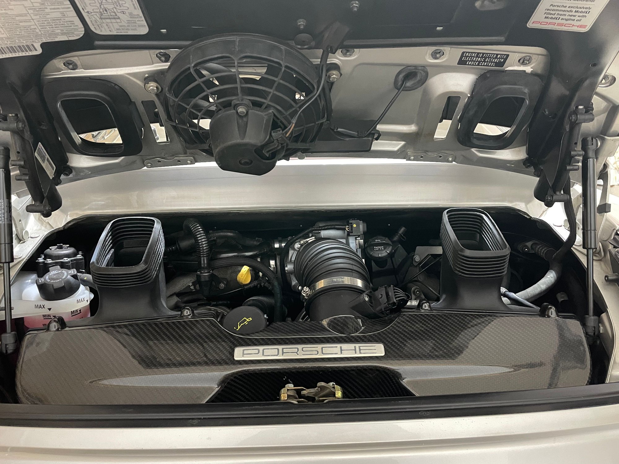

Finally got the dual intake deck lid on my 3.6 X51 2002 C4S. There are a few things needing adjustment but it’s all there and working great. It was not easy, let me know if you have questions and want to do something similar.
regards,
F.

Looks great. Maybe seal those slits with metal ducting tape to keep hot air from going into the intake
