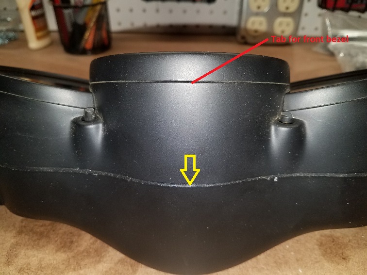

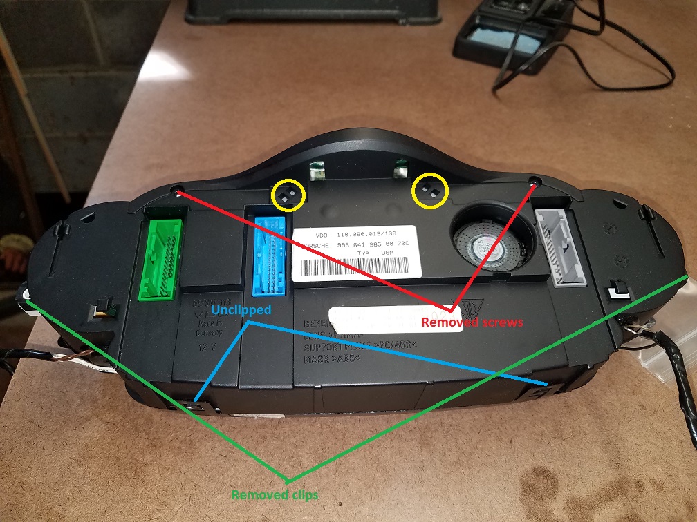

My instrument cluster is a bit different and I'm stuck The back of my unit is below, and I'm trying to separate it at the yellow arrow in the second pic, but it won't come apart there. Any help?

I had the same issue when I was dissembling mine, where your yellow arrow points in the last picture is where the clip is.
It takes some wrestling with it, basically the front half clips into the back half. Took me a few days opening mine because I thought I was missing something.
I recall gently pushing down whilst twisting the 1st half to the left to release the clip. When you do manage to get it free blow it with compressed air.
I will post a picture of the clip when I find it.
