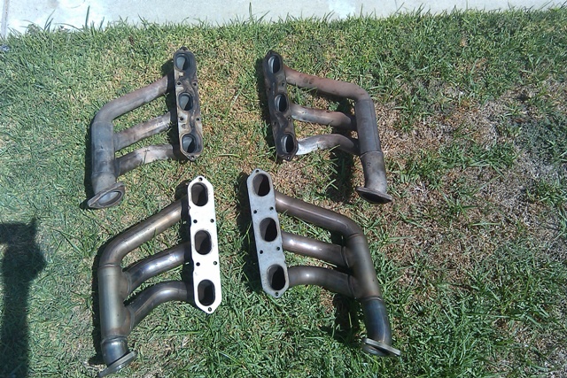

Originally Posted by djhill
I have a X51 motor without sport exhaust. Are my headers different than the headers on a stock motor?
X51 headers are definitely different than stock.
thicker diameter tubing... especially the collector pipe... the stock one looks just plain cheap next to the x51s
Hard to see in the attached pic... x51 on the bottom
