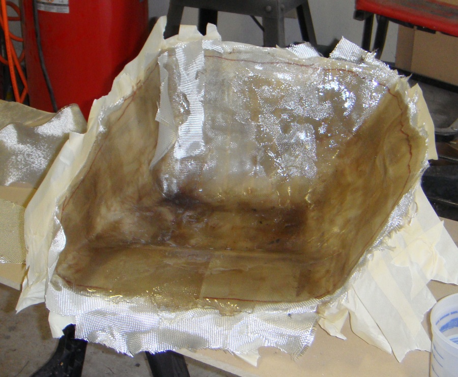

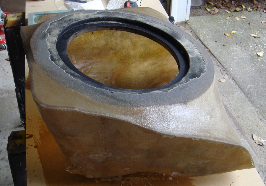

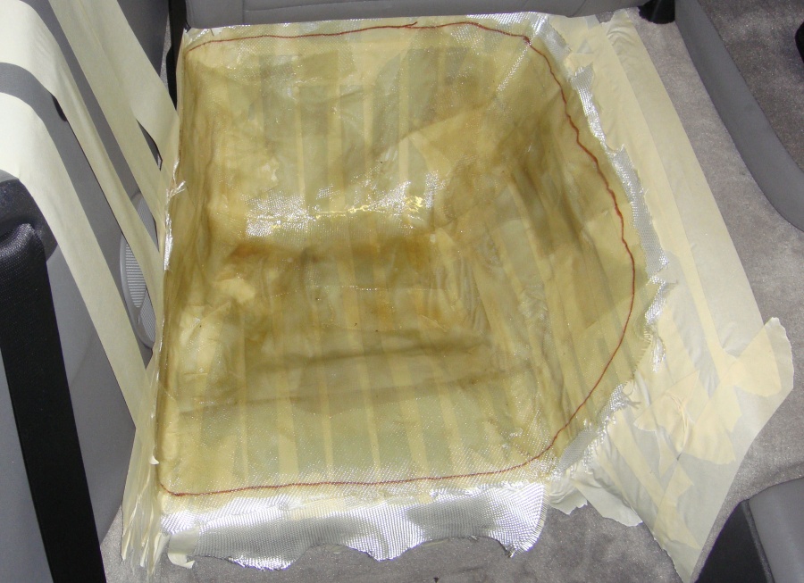

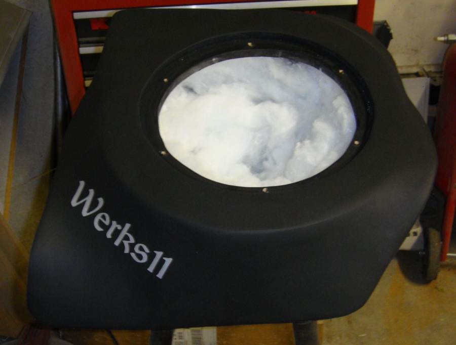

Here are some of the pics from one of the builds. It may give you ideas on how to construct yours.

Working in the evenings, I usually takes me about 1.5 weeks. They are a little time consuming.

Thanks Julian for the info.What is the underlayment you put on the seat before you applying the fiberglass?just tape with mold release?

The masking tape is all I use without a mold release. Use 2 layers of PAPER masking tape (no plastic types). When you pull it from the car it will take the tape with it and then I put a layer of resin over the residual tape stuck to the bottom so it can be painted. I only lay up 2 thin layers in the car as to reduce the risk of making a mistake. Once out, the layers are numerous. You have to lay up enough that the box will not flex under pressure. You should be able to stand on the box once complete without it breaking or cracking.
