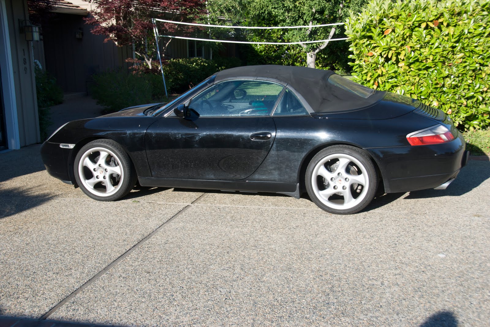

Bought my C4S earlier this year. Ran the 18" stock rims for a while then bought a set of factory 19" 2010 turbo rims. The 19" look better in my opinion and perform well, but I agree with the others that the 18" handle best.
Before
After
