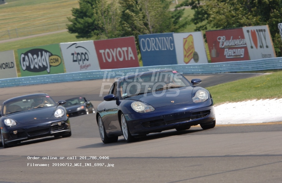

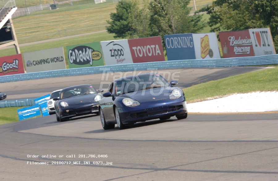

Here are some pics of the M030 in action at the Glen last summer. Pretty flat thru the turns.
