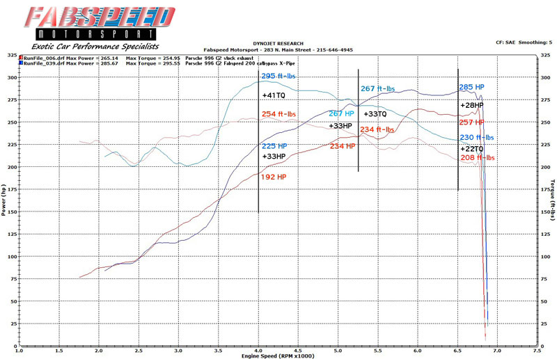

Dyno , cat bypass :

Alex, what kind gain does X pipes cat bypass with muffler bypass put out, not 200 sport cats.
This one.

They have the wrong site. Link:

I posted the dyno wrong because the site is' wrong.

I believe the chart posted is correct for a cat bypass pipe, it is just labeled wrong within the chart. You can see the low end drop off in torque between about 2700-3500rpm. I'm sure Alex would know if this is definitely the correct chart.
