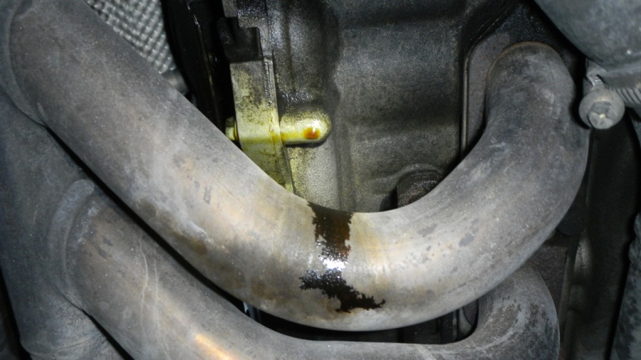

I noticed some fluid leak when I backed out the garage this morning..Could this be a bad sign of water pump failure....There's also a leak on the left side above the header & it's motor oil..I'd just got the the oil pan replaced and now this,,,Arggggggggg
coolant dripping...the expansion tank was replace not long ago..so its not the tank
oil dripping on the left side right above the header

The motor oil on the headers look like its plug tube/orings. It's a little hard to tell where it's originating from though. It could also be the cam cover seals leaking. Another possibility is the AOS. It's on the driver side top or motor and would follow the block down on that side but looks like it's at the very posterior so unlikely.

The second picture is an oil leak. Could be a spark plug tube. Again, clean it up and then watch for new oil.

there is coolant dripping down from the pulley area..I'd took it to RAC this morning & the tech guy said it's the water pump going bad..As for the oil leak , he said it's from the valve cover just from a quick look underneath..hope he's right & nothing else..damn..the price u gotta pay for owning a p_car, but oh well..seeing the smile on my face when driving is pricelss.
