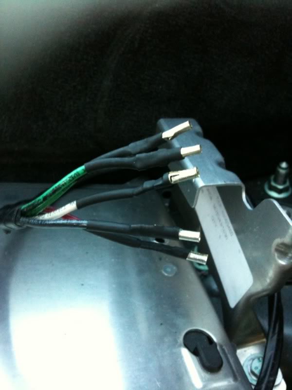

The install is complete.
My car did have the stock HAES 6 channel amp wired to two speakers in the dash, two in the quaters and 2 subs in the doors. The stock rear subwoofer has its own amp but needs a subwoofer signal. Also, the sub was stuffed before installation.
So, I made a 15ft loom and tapped it to the stock amp as follows.
B18 - rear sub (+)
B7 - rear sub (-)
A7 - 12v switched
B1 - Ground
B2 - 12v constant
as for wiring at the sub:
A2 + signal from amp
A3 - Signal from amp
A4 switched 12v from amp
A5 Ground connection (this is a brown wire)
A6 12v Power feed (this is a red/ brown wire)
Done!

Originally Posted by GMendoza
Clean wiring job but those wires look a lot like home electrical solid copper wiring insulation.
Old Apr 1, 2011 | 08:18 PM
GMendoza's Avatar
Joined: Apr 2008
Posts: 285
From: Alta Loma, CA
Rep Power: 35
GMendoza is a glorious beacon of lightGMendoza is a glorious beacon of lightGMendoza is a glorious beacon of lightGMendoza is a glorious beacon of lightGMendoza is a glorious beacon of lightGMendoza is a glorious beacon of light
Originally Posted by white99c2
I have the same Hi Fi Stereo in my '99 with dash, rear and door speakers powered by the stock HAES 6 channel amp.
Here's my question, can I go buy a Bazooka Powered Sub and wire it into the amp using the same wiring you did?
It should work although I believe the self powered bazookas' amp has a built on crossover. Not sure what would happen to the sound if you run it through a crossover twice. You may be batter off just tapping the rear speaker wires vs the subs.
Lol. Close, it's stranded.
