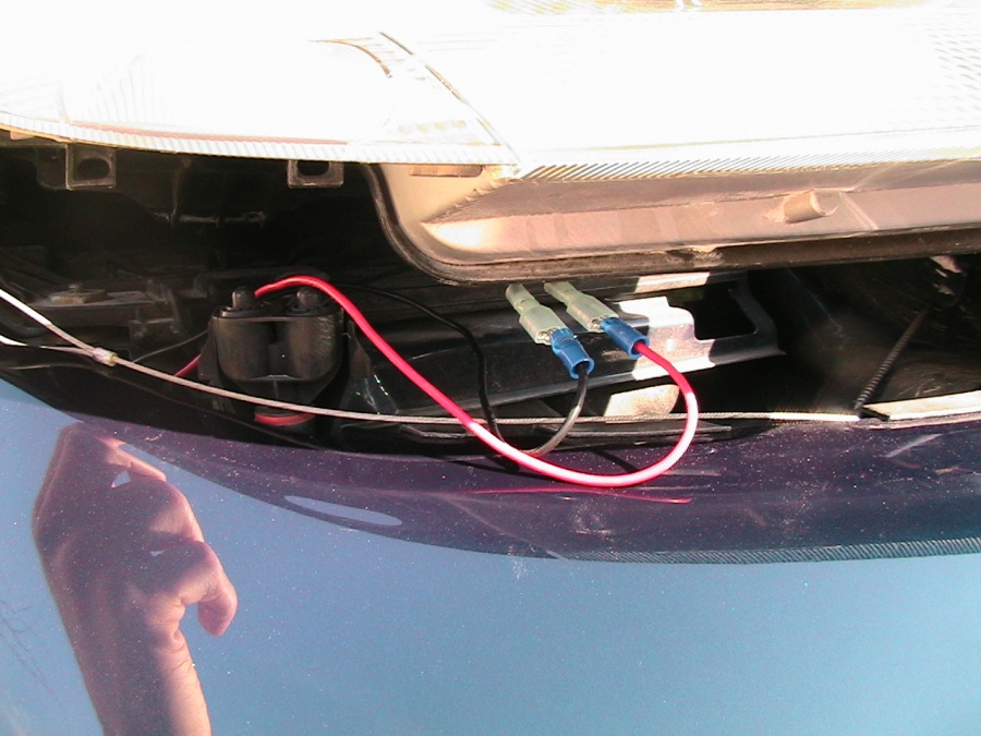

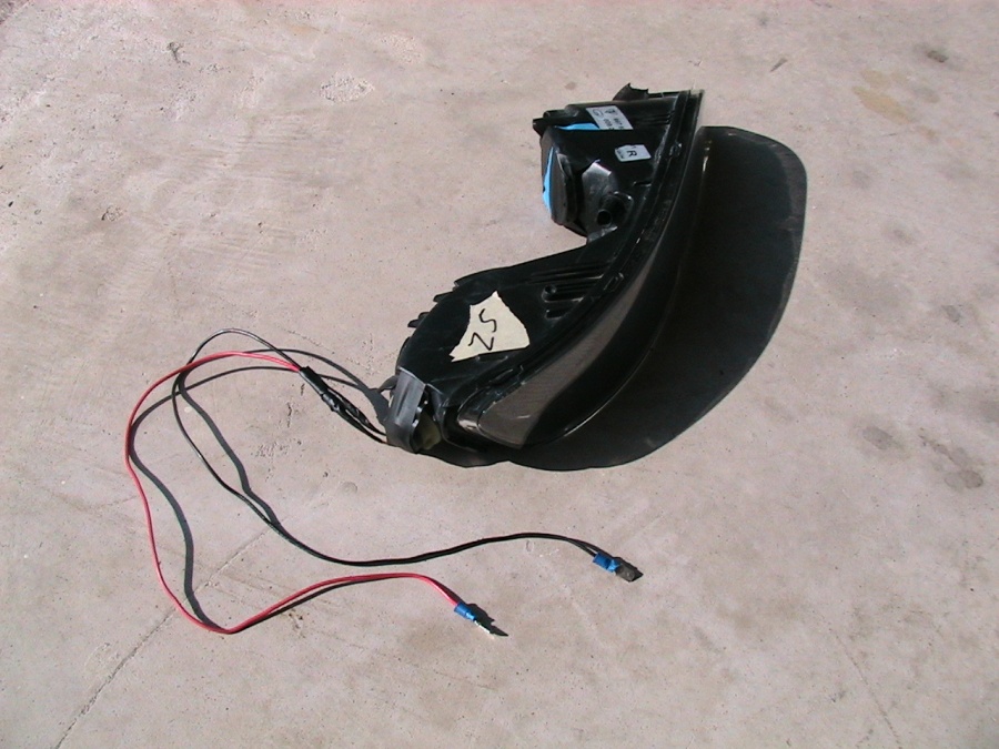

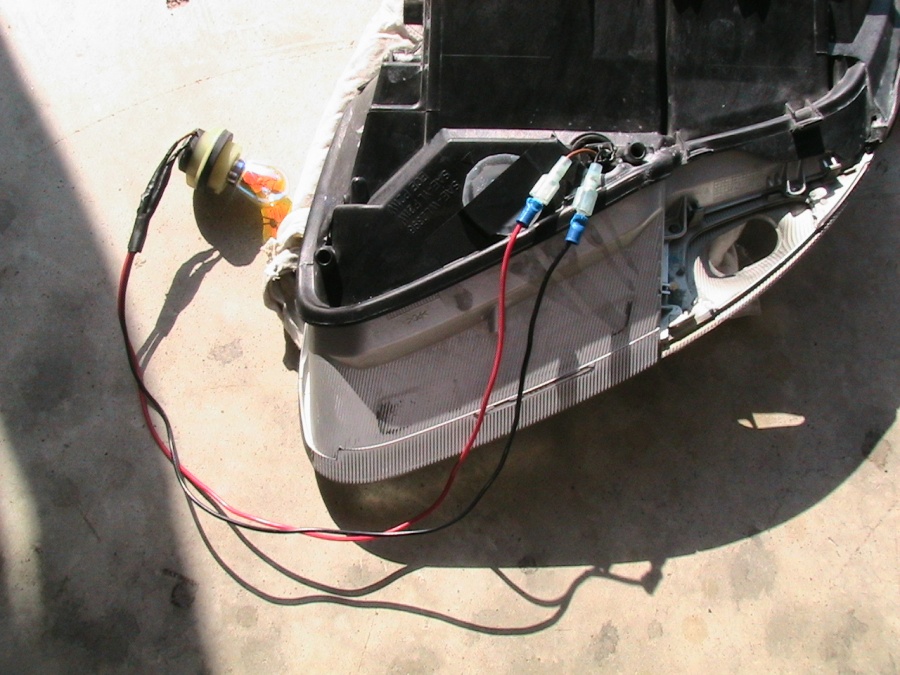

easy way if you don't mind ruin your headlights is to cut & splice your turn signals & fog lights wires..have it extended down to the 997 signal lights...pics below are for turn signal but same procedure for foglights as well...just make sure you have enough length so you can remove it easily. or use a male/female connector like I did.
