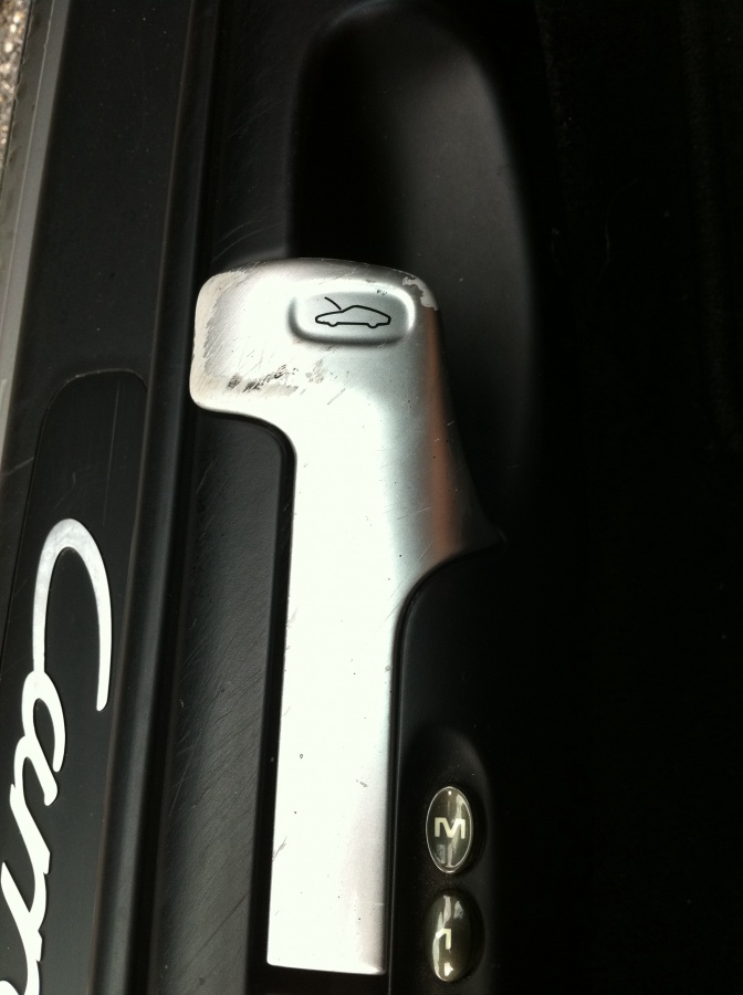

Anybody change out the release lever for the hood on the Pcar?
I have a replacement lever thanks to Aldo at Suncoast. What I need is some guidance, I really don't want to go in removing parts.

Hello CoolHand! I am in same situation as you ! did you solve it ? how to disassembly the plastic parts to access the lever to change it?

I changed this part last week ...and it was piece of cake to change it! just need to find and loose 3 allen 4,0 mm bolts on side of plastic parts inside de cab, after remove 3 plastic plugs covering the bolt access close to the seat then, loose thoss 3 bolts like 3 turns , remove the complete plastic cover trim directing it to upside ,then remove the trunk cables for both levers removing a bolt with a 1,0 mm allen wrench and the cable from the fixing plastic slot.so with the complete assemble in a bench you can change the lever removing the pin lock and the spring ..do the reverse operation to put it back ...and voilá!done!it´s require minimum experience and can be done in 30 minutes at most!
