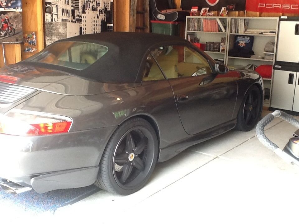

Here she is, it's slate grey metallic. I called Eurosport but they said they don't work with ecu tunes, I'll try fall line then. The guy told me my monitors are unsupported and have my mechanic take a look at it. I was surprised coz I passed last time.
