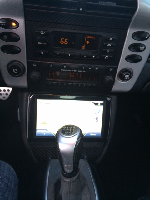

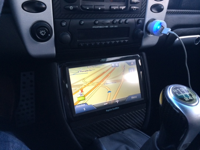

Just finished doing same mod to my new to me C4S- Again like on my First 996, turned out perfect, and now you can buy the same GPS unit for $100 - This mod is a must for any 996 to totally update the interior- Thanks TAREK307 for discovering this set up lol

just buy one from ebay man! read first thread post for all details, back then it was 300 almost, now its $100 on ebay
