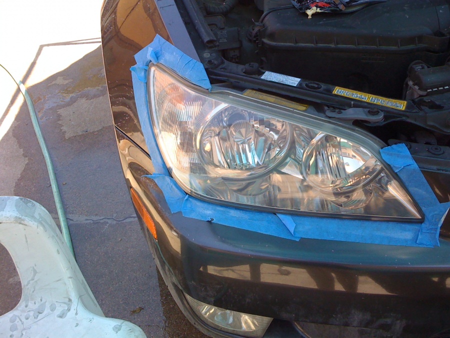

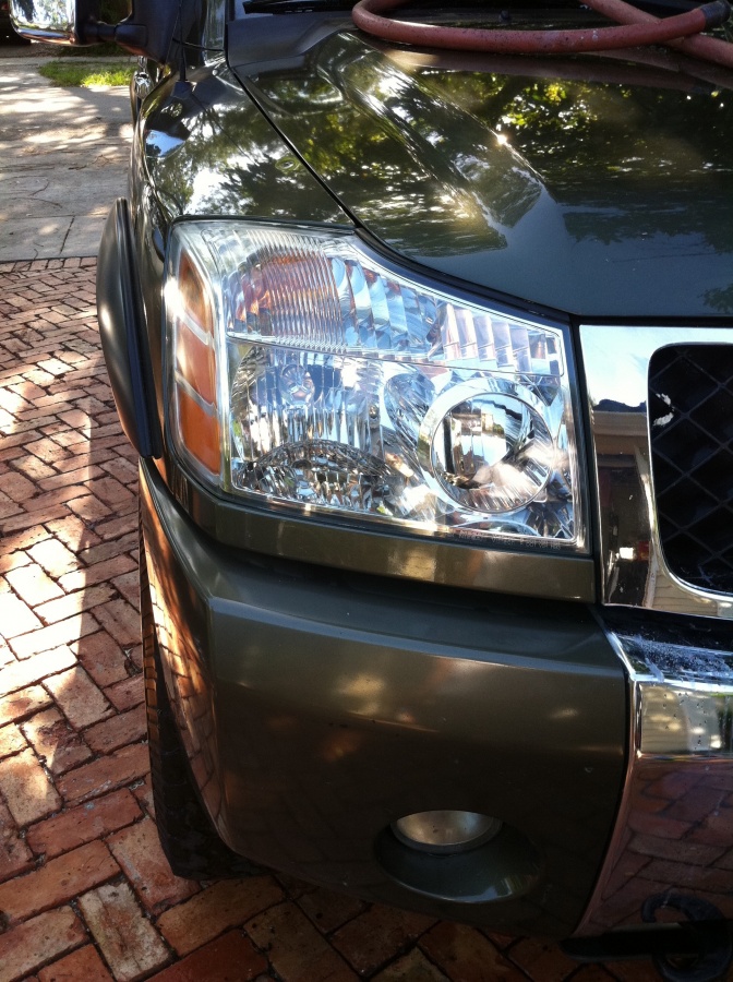

Before and after on the Titan. Definitely not going to DIY on the 996. Over all great results but it take skill with the drill. I messed up my lens in a few spots so I am going to have to get another kit. If I can get the 996 done for $90 I am pulling the trigger.
Anybody know of a good place in S. Florida?

Before

After
