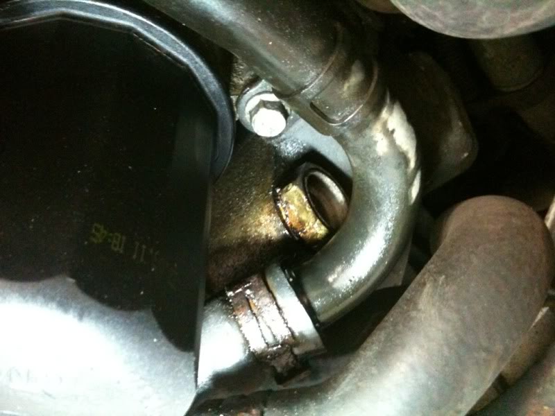

He found it is coming from here, next to the oil filter:
He is not sure what it is, maybe a oil pressure release valve?
I need to know what it is to buy a new copper washer/ part..
Thanks very much in advance

If you are referring to the large hexagon-shaped bolt, that is a timing chain tensioner. Do not remove it without locking the engine at TDC! If the leak is minor, probably not worth fussing with.

Definitely agree don't fuss with it.
To repair the leak safely, you need to lock the cams, lock the engine at TDC, remove both bank 1 and bank 2 tensioners (bank 2 is a PITA because its under the aircon), then remove the IMS (main) paddle chain tensioner (the one in your pic). Then replace the washer and re-torque.

It's going into porsche to be done on wednesday
1.4 hours for the job (both sides) @£99+vat /hour labour (reduced from 120 as it's 'old')
+ while im there wheel allignment for 'only' £150, special offer as they have just got a new machine, for £28k
Can't live with an oil leak

That sounds reasonable to do the tensioner washer, since to do it properly it should include locking cams and verifying timing afterwards.

Logray, just out of curiosity. How prone are the tensioners to leaking? After doing my IMS I'm wondering if one of them (bank 1-3 on a 3.6L) is leaking.

It's an aluminum washer, so as long as it is torqued properly I can't see it leaking very much. And it wouldn't be the tensioner leaking, just the area around it where the oil can seep past the washer and base of the tensioner.

how many tensioners are there? 1 each side?
I got that impression from the parts department at the dealers, he said the parts will be £9 a side

There are three externally accessible chain/paddle tensioners.
One for cylinders 1-3 chain, one for cylinders 4-6 chain, and a third for the ims to crank chain.
The washers are about $1 USD a piece, retail. There are also o-rings on the tensioners, which are also probably about $8 USD a piece, retail.

Are the metal washers on the outside 1 time use (crush washers)? Obviously I took them out to do my IMS and I'm wondering if they should have been replaced....

Yes I believe they are dispose of single use... that being said I didn't replace mine when I did my IMSBR, and they didn't leak - are you certain use torqued them properly?

Got out to the car in the garage yesterday. When I put them back together I couldn't find the torque spec so I did them 'good and tight' - so I was pretty sure (after your comment) that they weren't down enough. I'd say the main tensioner was at ~45 ft lb and the 1-3 bank (not leaking) was probably closer to 35 ft lb. I put both of them down to 59 and did a test in the garage. After idling for over a minute there was no leak - so that's a good sign. The real test will come once I get to do another drive.
