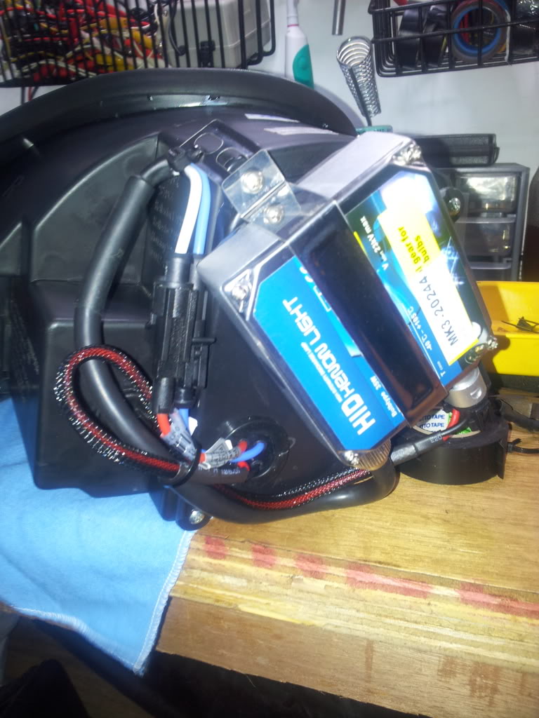

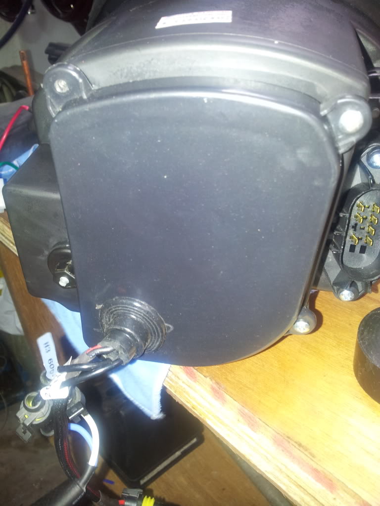

Originally Posted by geetee
I've been running HID in low and fogs without any problems. Since about 2 weeks ago passenger low does not come on. I've switched bulbs/new ballasts etc tried everything. Pass HID does not work. If I go back to halogens, both sides work without a problem. Now, HID lows driver side no problem. HID low passenger side keeps blowing the 15amp fuse.
I have the red wire from ballast plugged into headlight and black wire, I have grounded to the post that is holding the headlight housing. How do you have your low's grounded?(black wire from ballast)
Got worried about this because I have my HID's simply wire tapped to the original receptacle inside the assembly - no grounding wires or anything complicated. Will my DIY HID install need to be grounded to something? Will my simple wiring eventually need some groundings?
My C2 is a 99 Model. I hope this means My electrical system is not yet fully dependent on the onboard computer right?
Old Jan 10, 2013 | 05:29 PM
  #138
geetee's Avatar
Joined: Apr 2006
Posts: 1,346
From: 19454
Rep Power: 90
geetee has a brilliant futuregeetee has a brilliant futuregeetee has a brilliant futuregeetee has a brilliant futuregeetee has a brilliant futuregeetee has a brilliant futuregeetee has a brilliant futuregeetee has a brilliant futuregeetee has a brilliant futuregeetee has a brilliant futuregeetee has a brilliant future
I got mine sorted out. For the low beam, the connector to the H1 bulb has black plastic wrapping around the 2 wires yellow and brown. You have to cut the brown wire and use as ground. Plug the red wire from ballast in to the low beam connector like you would do to a halogen bulb. Connect the black wire from ballast to brown wire. I bought a female connector so the brown wire would lock with the ballast black wire.

Originally Posted by jateshk
where can i get these? Are these plug and play without error codes?
What error code? On my 2000 996, you can remove a bulb and the computer seems not to know it.
I got my HIDs from DDM Tuning. This is my 5th set from them. I have installed them now in all my vehicles. Have had one ballast go bad, but DDM will replace them forever for free. Its all plug-and-play except for drilling a hole in the access panel on the back of the headlight housing and attaching the ballast. I have had mine in the Porsche now for about 6 or 8 months with no issues. This includes several multi-hour night trips.
