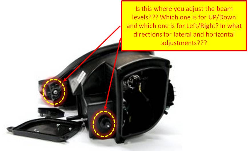

Guys, How do you adjust the level of the beam on these headlights???
I saw 3 plastic hexagon nuts at the back part but I'm not sure which ones you turn for up - down, left - right and in what direction do you turn???
I wanted to just experiment but the only way to turn this nuts is when the headlight assembly is dismounted :-( HELP! :-(

Cant sleep! Tossing and turning in my bed so i decided to sneak out to the garage :-)
Anyway i dismounted the 2 headlight assemblies and experimented on those hex nuts. Found out that the one on the top part adjusts the Projector beam left - right whilst the hex nut on the bottom part is for up - down. I discovered that there is a flaw on these headlights and that is if you adjust the projector to go up and over do it - the projector lid will hit the plastic lens :-( i actually scratched the plastic lens.
After several trial and errors, mounting, dismounting, clockwise, counter clockwise turns. I finally succeeded. I was able to bring up the beam to a satisfactory level but now i find the high beam quality to be inferior to my low beam HID. My high beam bulbs are H1 Philips halogens Diamond Visions. Should i also upgrade the highbeam Bulbs to HID? Can the housing actually handle an additional HID load/ballast?
