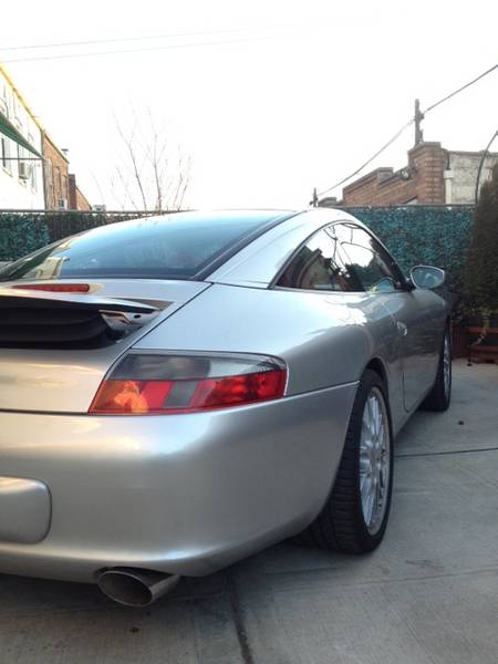

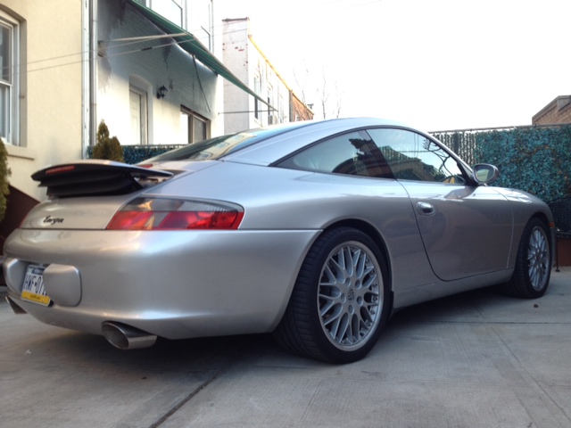

Old Feb 2, 2012 | 09:50 AM
Mamut79's Avatar
Joined: Aug 2010
Posts: 299
From: NYC
Mamut79 is infamous around these parts
So I have finally came about taking some pics with 7 and 15. Looks just the way I wanted , flush....cant wait to get some coilovers to get those nasty gaps eliminated.
