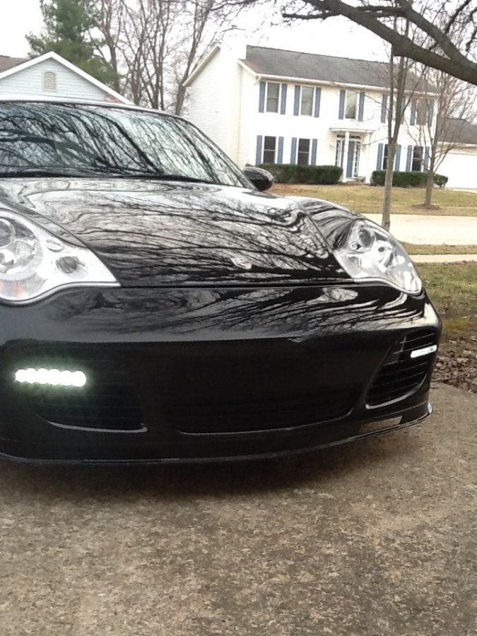

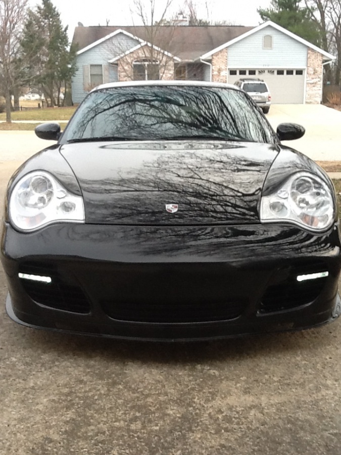

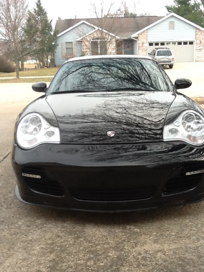

Here are a few pics i took with my iPad.. I love the look and like I said this was done without taking the bumper off. total time of about 30 mins.

and some more
enjoy
