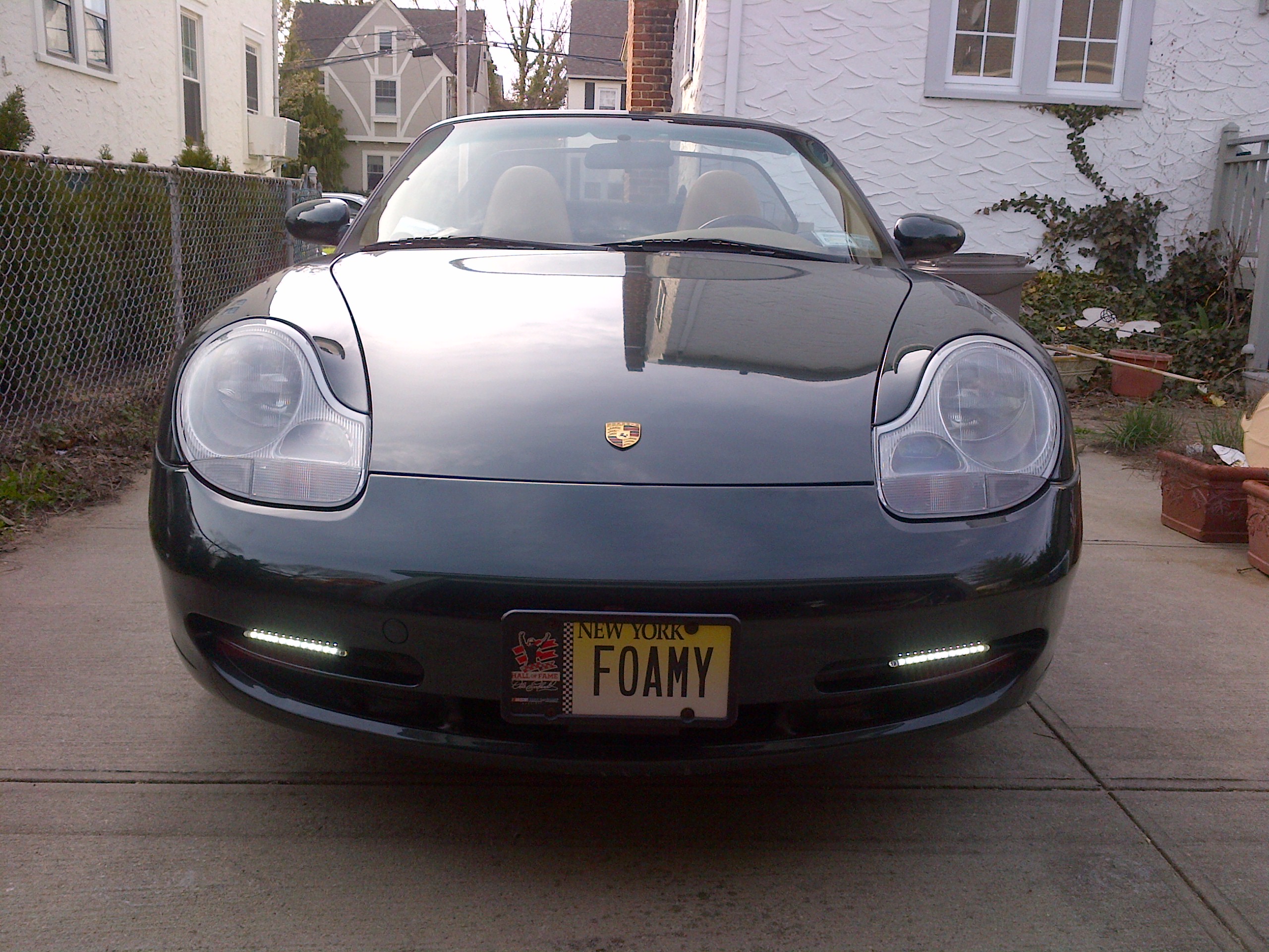

I finally came up with a solution that works for me (MK I stock bumper). I bought a pair of LED DRL lights from Custom Dynamics http://www.customdynamics.com/daytime_running_lamps.htm
I got the 12 LED 6.97 inch Truflex clear tube version for $22 each
I bought some 3/4 inch angle aluminum and cut it the same size as the tubes (maybe slightly larger). The lights have 3m tape on the back which I used to adhere them to the aluminum. I painted the exposed aluminum black. I used 3M tape to mount the assemblies inside the bumper. I already had a source of switched power in the frunk which I tapped into.
I'm really happy with the results and get a lot of compliments. The photo doesn't do it justice brightness-wise. They are very bright.
That looks very good. Do you have any other angles of the front you can share?
How long did it take you to the mod? Where in the frunk did you tap in to get to the power source?

I'll take some angled photos. The lights are recessed so you really don't see them from the side. I removed the bumper to do this which is a 15 minute job if you've done it before and 30-45 minutes if you haven't. There is a great video on YouTube that shows it step-by-step. My car has a laser diffuser installed and I tapped into that. You can run the wires through the firewall and tap into the switched output of the telephone module in the front center console.
