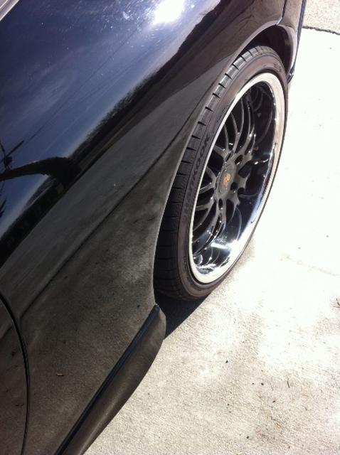

My 99 C2 NB originally wore 18X10 ET65 at the rear. Currently, I am running 19X10 ET50 at the rear; a negative 15MM difference. The rear rims now sit outward just enough to produce a pleasant aggressive appearance at the rear. They actually make the rear portion of my P-car appear wider. I likey.

Old Jan 31, 2012 | 02:23 PM
rrrruben's Avatar
Joined: Aug 2010
Posts: 418
From: Novato, CA
rrrruben is infamous around these parts
Here you go:
